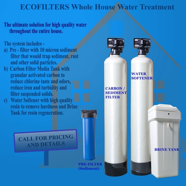

                  We use something similar to this
Name:	Water treatment.jpg
                  Runs pretty cheap. You do have to haul salt
                  Likely need further upgrade for drinking such as a small RO
                  A local reputable plumber can set it up. Buy quality
