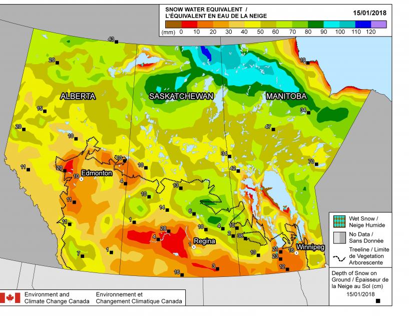

    Yes things could change but the map shows snow run off to date. Not a real good feeling even if its still early.

    The NE and above the valley has snow or has had moisture since fall, but that sure is a huge area of dry.
    So with 90 days till seeding starts on our farm it looks like, Half canola and half wheat for best chance at a profit. Swing acres are 500 barley and 500 peas. These will be cleaned and we won't make that decision till end of April or even up to go date.
    This is serious and should be discussed its not a great start and we need a lot of moisture to replenish what was used last summer. One snow dump won't get it back and if nothing happens till june i think some areas are done for 2018.
    Its still early but these maps suck.
    What are others thinking or planning. Will some SMF or Chem Fallow or will guys seed for Crop insurance hoping it starts to grow so its established and then it can die.
