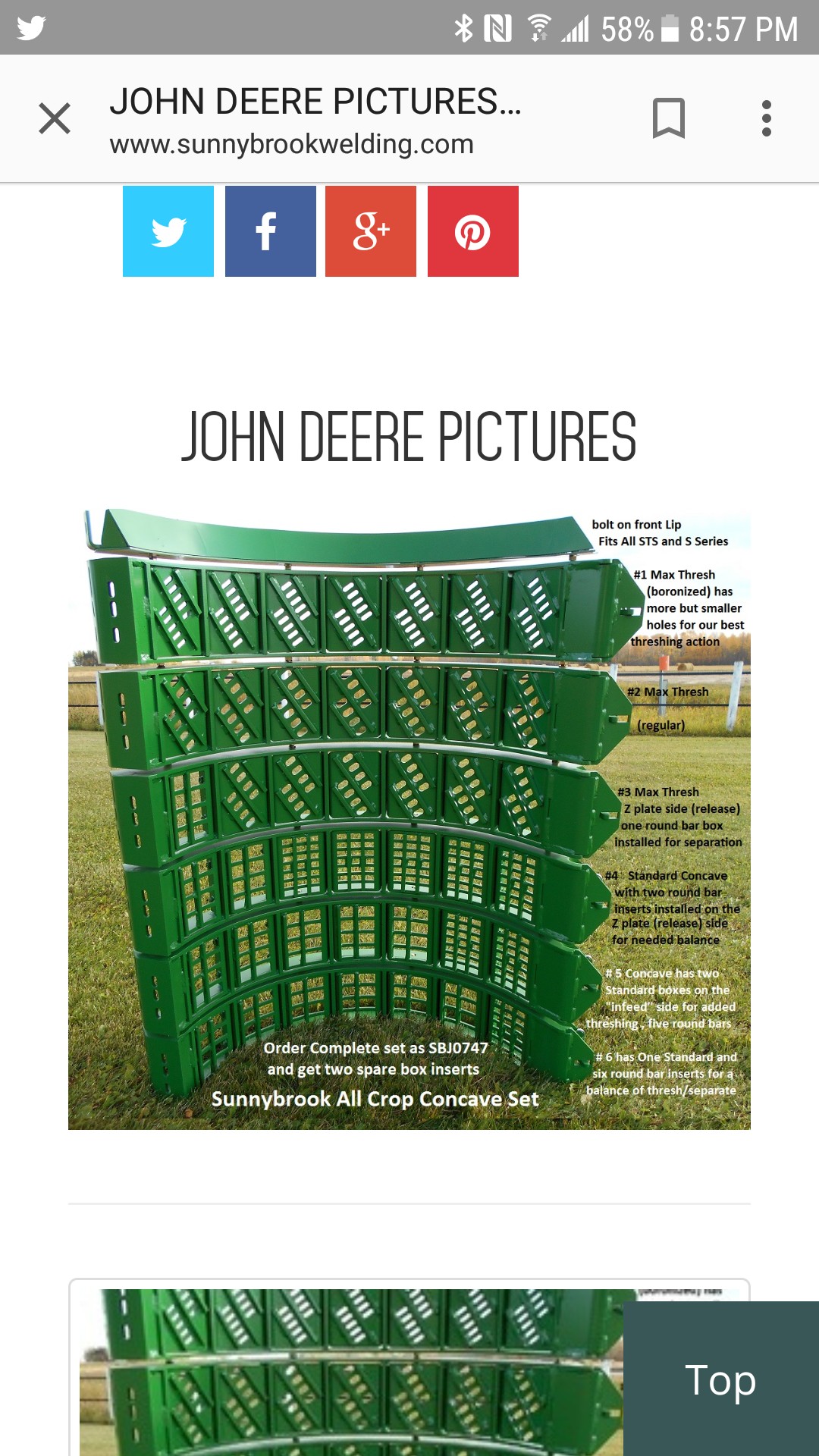

    It's time to replace the concaves on our 9870 there is john deere small wire in there now. Should we be looking at after market concaves for durum,barley,lentils and canola. In our 9770 the front concave is a helical and we only run 1 filler plate under where return comes in and has a cleaner sample then the small wire with more filler plates. Looking for other options.
    Talk to murray at madd concaves He is making halfsets for jd that are easy to change like case

      Buy Sunnybrook concaves....long life, no wires, no filler plates, just combine....one point larger concave setting, slower rotor speed, no loss....enjoy harvest!!
        Go sunny brook you won't be disappointed.

          This setup for the crops i have in the original post
            go sunnybrook. amazing diff from junk jd concaves

              Like the picture above but no need to buy the last two sunnybrook concaves just pull every second wire on your old john deere small wire.
