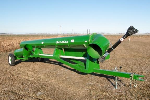

                  When 1 inch on a quarter is 3.63 M gallons and you have 50+ M gallons laying on a quarter you realize the size of the problem.
                  A 16 inch low pressure would make your water move but then you have to have somewhere for it to go.
                  Long term the water has to go back where it came from. This year put a big dent in our excess water problem.
