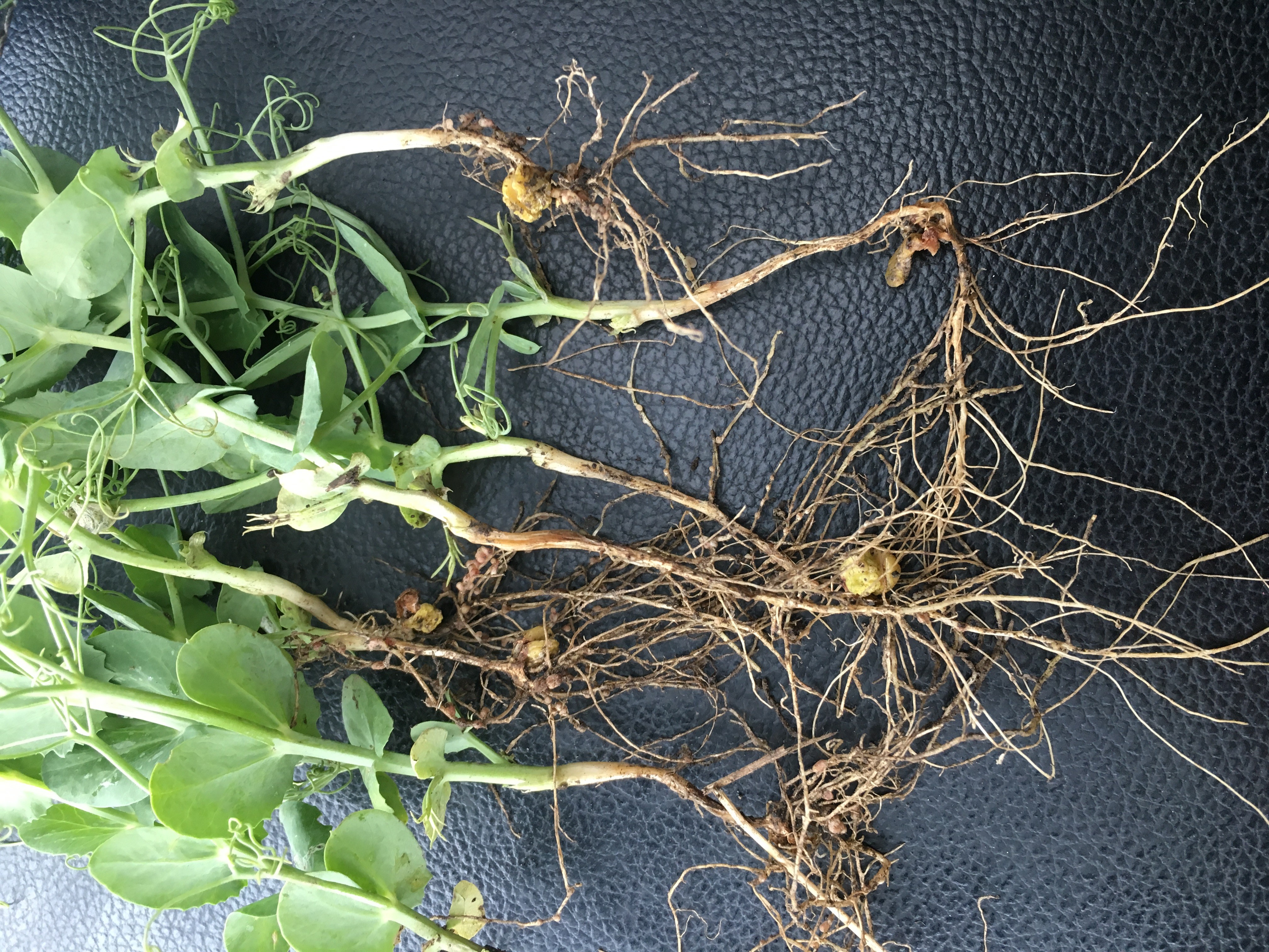

        • 22587
        These plants were very healthy one week ago . Roots were checked about 10 days ago looked good .
        Never had much rain so I was not concerned about root rot at all .

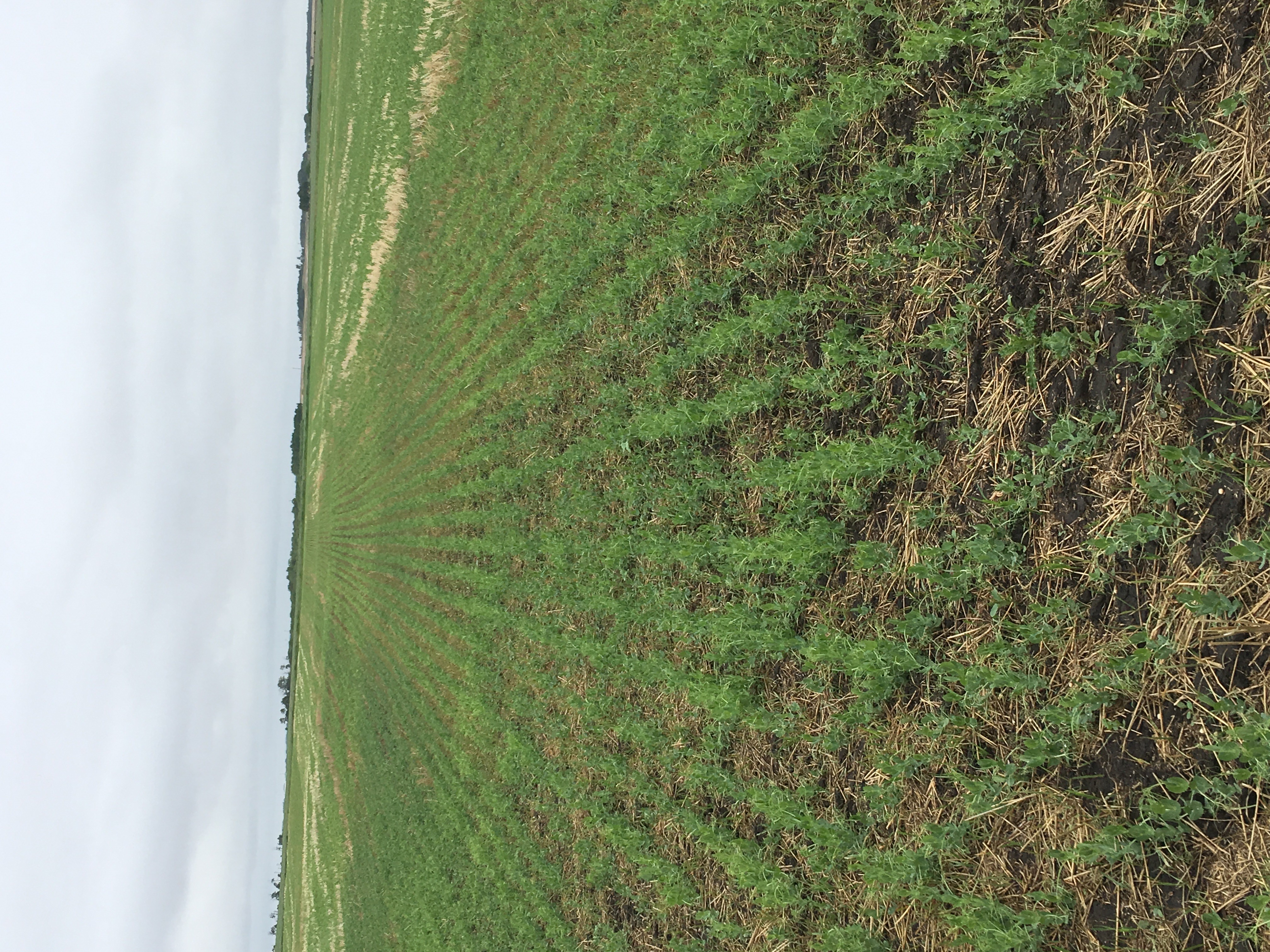

          • 22587

            This field has heavy clay gumbo.
            The worst effected peas are where the heaviest gumbo areas , unfortunately that's about 60% of that half section.
            Much the same as the root rot a few years ago , low spots and anywhere the soil had more clay . I know a big part of it is compacted soil there.
            Need to loosen up and mellow out that soil before peas ever go back on that half again . Might be 10 years now lol

              As long as the nodules keep alive those peas can make a crop. Seen that here quite a few times and harvested 50 bushels. Stems will turn brown above ground and plants will be flat once ripe if it rains. Seemed like xemium in priaxor ds helped a little if sprayed early.
              Nodules dead though and it won't yield much. Spreading Lots N will get 20 bus/ac vs 0.
                • 22587
                59-70% infections, noduals dieing
