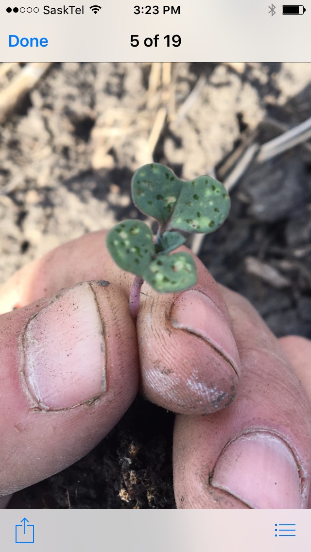

    Just finished up seeding and making the rounds, only to find a field nearly devastated to hungry flea beetles. Hope the wind stays down so I can get it sprayed, otherwise I'll be reseeding.
    Plan to use Decis5EC and throw in 200 grams of Glyphosate as there's some volunteer wheat coming now.
    Anything better to use as an insecticide?
    Guys, check your young canola.

        Also try to remember not to get too excited... fleas need to eat to die :
        This is only 25% ..

          The danger is loosing that tender first true leaf, the one in the pic still looks good.
