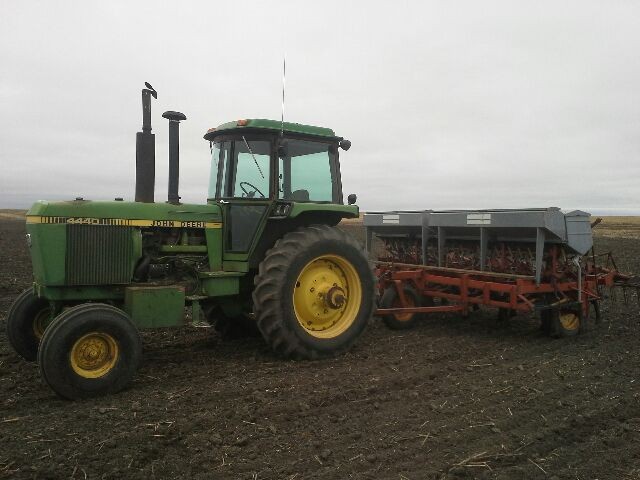

    No Fert other than what I spread on the other day that was left over in the seed cart(bigger potholes only). Seeding "Rig" is an old 14 foot Seedrite with the mounted rod assembly removed and harrows mounted on that square tube so when you lift the openers out of the ground the harrows lift as well. Pot holes have to preworked to use this thing.
    Usually try to seed the same grain as is in the rest of the field unless it gets too late then the only thing I care about is getting something growing in those spots, other than weeds, to use up the moisture so that maybe we stand a better chance of getting into them next season.
    We just use normal seeding rates. Shallow for quick emergence would be good, when you can.
    This operation is anything but high tech.... just get something growing in those spots.
      • 17493
      A little embarrassing but WTF, gets the job done.

            Why would you take the rod-weeder out? One of the best weed killers ever. I have the same unit ( pulled by a 4230 though haha ) haven't used it in years though.
              • 17493
              Stoney, weren't those things horrible in trashy conditions. Alot of the pot holes we're seeding this spring were tilled and rolled with a land roller last fall, so they are in decent shape.
                They didn't care for hardheads either ( pretty hard on the rod ) the fert. system was a disaster, but in decent conditions i always liked the way the rod layed the weeds on top of ground.
