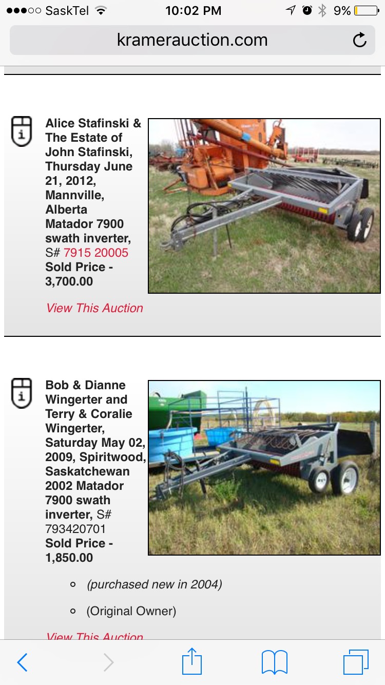

    Anybody know where there is a Matador Hay Inverter for sale ?
    Gotta get these barley swaths off the ground somehow !

    if you havent go ask the same question on the combine forum. Years ago alot of guys built swath movers using old belt pickups or sunds one may be in a shed somewhere.
    • Klause
      • 3644
      A round baler works better as it isn't as rough. Open the back up and pickup lifts it bottom belts drop it out the back again all fluffed.
      Our deere 587 has gotten borrowed this spring already and after the snow last fall (one of the few guys with a baler around here haha)
      If you're not too far from Humboldt your welcome to borrow ours also.
      • BreadWinner
        • 1499
        Matador is no good, it kind of rolls over and all the heads will be on the bottom side. Klause is right just pick it up and set it back down.

          Thanks, we were thinking to remove the mold board so it wouldn't do a complete 180*.
          Just found a guy renting one at Vegreville, just east of us so we may try it out.
          If not my brother has a nice baler.

              I have never seen a matador but for the price of you can find one seems cheap
