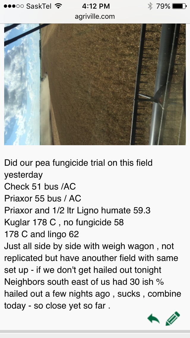

                      • 22660
                      From last fall ..
