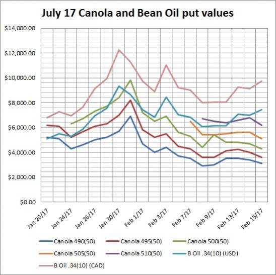

Name:	Canola BO puts.jpg

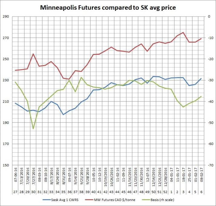

Name:	Minneapolis futures compared to SK avg 1 13.5 CWRS.jpg

    101, how are you calculating your basis line on the wheat chart? Against what? (Deducted from what)
    Canola and bean oil puts are moving in different directions. Does that translate into more volatility in the bean oil market than the whole seed canola market?

      The basis read on the right hand scale is the value for:
      Avg SK spot price for #1 CWRS minus the Minneapolis futures priced in Canadian dollars.
      I thought I would try calculating it that way so it is not a positive number
      July bean oil contract is weak since Jan 20 but has slowed its descent.
      Canola has been doing relatively well, thus the reason for the loss in value for July canola puts
      You can pick up a 510 July put for the same price as a 495 put was on Jan 20
