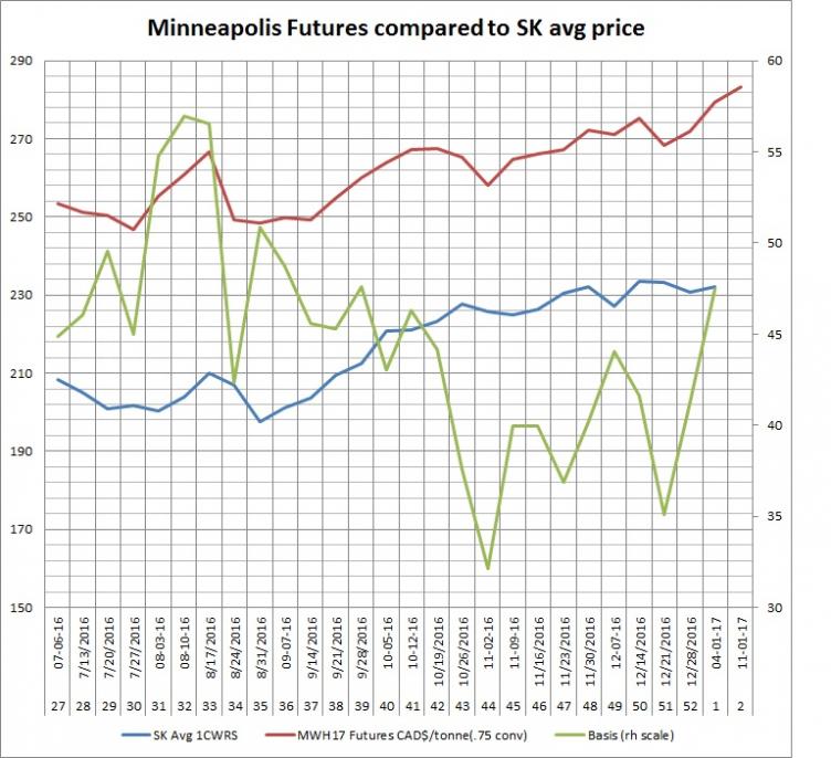

    The pop in MW is not trickling down to farmgate pricing in SK.
    The chart uses the Sept contract till Aug 1, the Dec contract till Nov 1 and the Mar17 contract till present
    Minneapolis prices are converted to CAD@75 cents and tonnes, taking into account the difference in bushel size (PDQ doesn't bother to do that and neither do the graincos(I guess it is in the basis)
    SK avg price for most recent week not entered yet but looks like there will be no change in most areas. Will update. The oldest months are a little off because the dollar was 1 or 2 % higher for a while. A 76.5 cent dollar would narrow basis about $5/tonne
Name:	Minneapolis futures compared to SK avg 1 13.5 CWRS.jpg

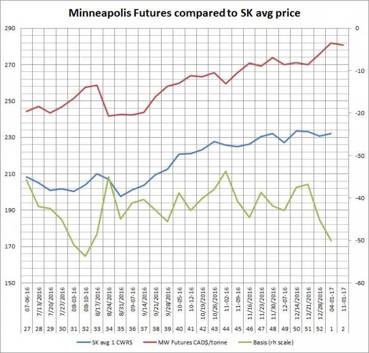

    A more accurate FX and also changed the scale for basis so that it is negative

    No no no .....the exchange is in the basis. .....hello John depape. ...please enlighten Mr. Farming101.
    The whole pdq is a crock of shit. .... go to a website where contracts can't be signed...every grainco sends texts everyday .....Viterra has an up to the minute app....and Yerry feeds depape 750k.....makes me sick....

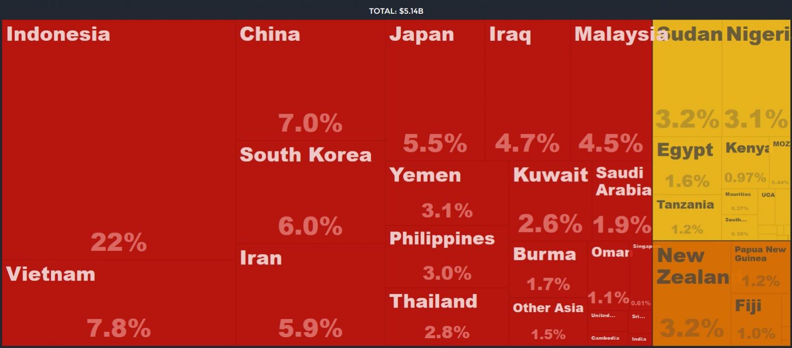

          • 3959
          Farma I think you did all right too.
          I don't know when new crop Oz wheat hits the market in a big way but I think it will put a cap on things. The way Mallee talks they will be looking for places to put their crop
          They do market to a somewhat different lineup of countries but there is overlap too.
          2014 Aussie exports
Name:	Aussie wheat exports 2014.jpg

            It would be nice to see some sort of consistency as to how the basis is calculated. Even if it was off of Minni Wheat or what ever..... West coast quotes or "asking prices" are just that.
            We would need a starting point whether that is the West Coast or Lake head east or Minni wheat. We don't have a functioning futures market for wheat in Canada so what would be the best price source to start deducting basis from..... and then everyone would have to use it depending on the direction the wheat is moving.... This is too complicated for this simple mind to unravel but something should be in place.
            Any suggestions?
            Its hard to complain about wide basis when comparing one buyer to another..... it's a signal they don't want it if it creates an out of the market price. We are in a new marketing environment, there will be signals.
            Some one want to stick their neck out and calculate what you think is a "fair basis"? Based on what?
