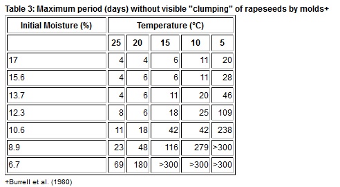

          At the higher moisture levels you can set a timer according to this chart. When time is expired it will be warm.
Name:	Moisture Temp Canola chart.jpg
                    [ATTACH]753[/ATTACH]
                    That chart may be accurate at lower moisture, but I can attest that at higher moisture, it will start heating long before the chart says. Finished up last year somewhere above 16, guessing 18. at well below zero ambient. Didn't want to mix that with better stuff in aeration bins and risk it all, so I just moved it constantly. Could only get a few days at a time in one place.
                    Once I had some space I spread it a foot thick or less in multiple bin bottoms and regularly shovelled it around. In the middle of winter, and it still wouldn't stay cold. Eventually freed up some aeration space and aved all but a small amount that my hired help neglected to stir while I was away.

                      AF5 I hope the chart doesn't mislead anyone. This is the maximum days before clumping. It could be less.
                      Also once canola starts heating it goes critical. Just moving it doesn't seem to stop it. Into a fan bin or a drier then.
