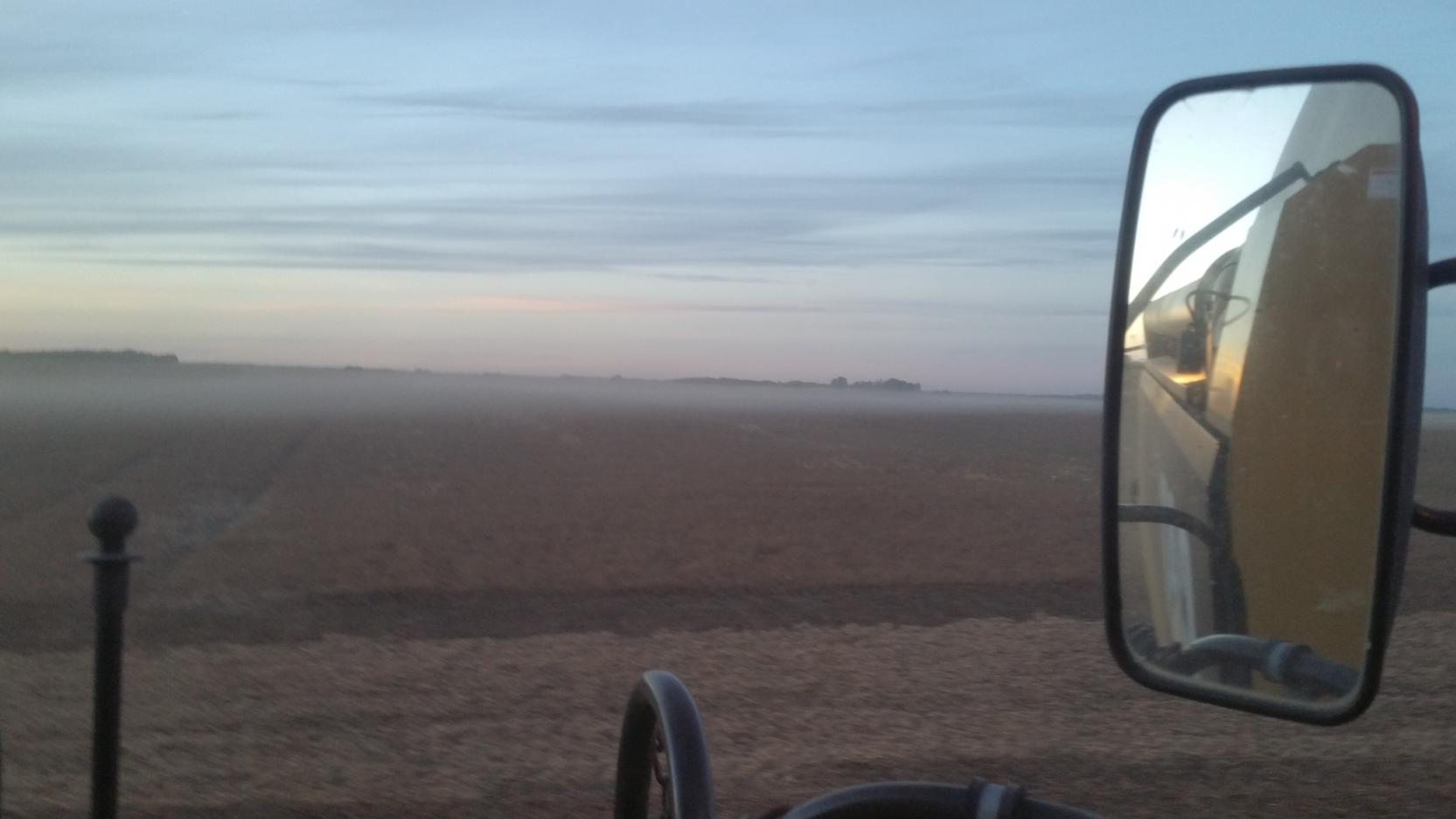

    Flat
    60 plus bu peas... at least...
    4 inches high. Ugggg

    Do you use lifters?
    Or
    Mcdon header tilted forewArd?
    It does feel good when you go over and you get 98%

          Ours peas did not go totally flat, but where they went flat and you went with the lean, we missed quite a bit. Maybe need to look into the macdon headers. We have lifters but how close do you run them to the ground? We are not flat land so do not want to break the lifters. They are those new schumacher flexi finger ones.

            Been using those lifters, they work great! extremely adjustable.

                Maybe we are talking about different things here. But if we are talking about the Flexi fingers that I bought they were truly the worst $2500 I ever spent.
                If you position them where they need to be they bend and break. I try them every year and every year I spend a couple of hundred bucks to replace bent and broken ones. I won't be using them again
