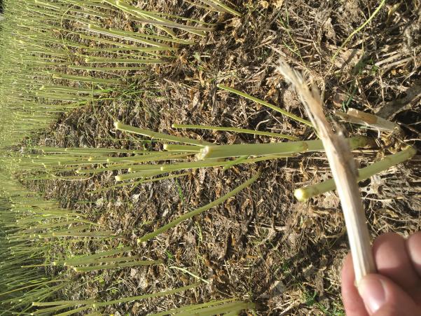

    Ok canola in area we were told spray scary spray buy all advisors from line companies. Wet conditions breed disease. Spend Mr Farmer thousands upon Thousands of Dollars.
    So far this is the results I have seen.
    What we used Proline!
    New BASF fungicide out 2018.
    Aceppella
    What I have seen so far is plants dead at swathing or drying up 1 in 30 on average on untreated quarters. Why screw around with 40 acres.
    Fields sprayed with any of the above 1 in 32 plants best to 1 in 29 worst.
    I would say the test was correct as one in 30 plants will not effect yield. These plants are now just dying and are in the swath.
    So is the testing system correct and works?
    Were the line companies looking for profit and profit is good at all costs.
    Is it all smoke and Mirror.
    Or is it more cosmetic the crop looks better?
    Will try again next year but so far this is what I have concluded. 2016 was not a heavy year for serious out brake our area. Now some other areas yes way severe. Will try more tests next year probably 1/2 of all our canola acres.
    Did any one else use the test and did it prove positive or negative. Because will it become another tool in our tool box to help the fight of over spending on farms. Why spray if you don't need to.

    Sprayed every field of canola with Proline.
    Left a sprayer pass on a few fields to see difference.
    Very visible from the road. Lots of dead plants on unsprayed pass.
    Just the odd one where it's sprayed.
    Actual net benifit? Who knows...
    I believe it "paid" this year to spray in our area but last year was a complete waste of money.
      Thats kind of what we found in the past some year total waste of cash vs some years it saves your bacon.
      So did any one try the test for disease.
      If it really works it can save $100,000.00 in expenses that is better in the farmers pocket than the Chem company and dealer networks bank accounts.
