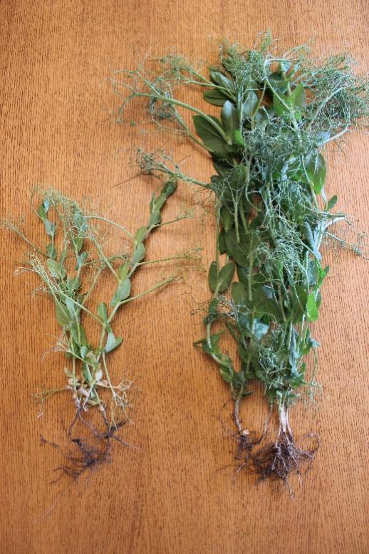

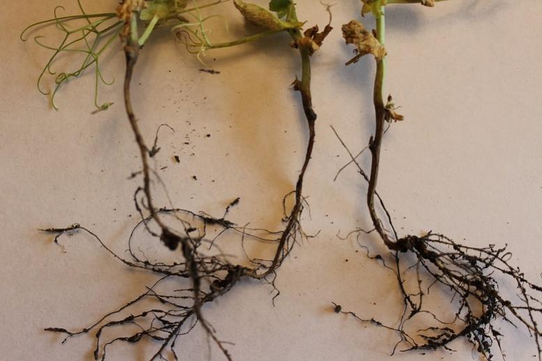

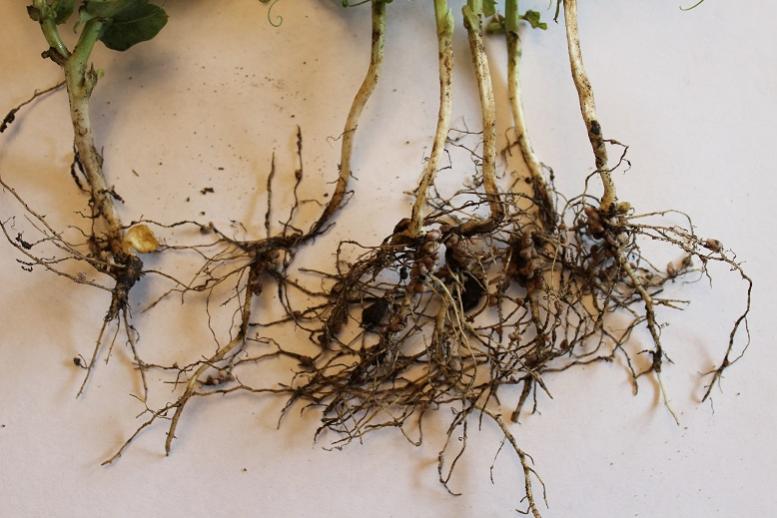

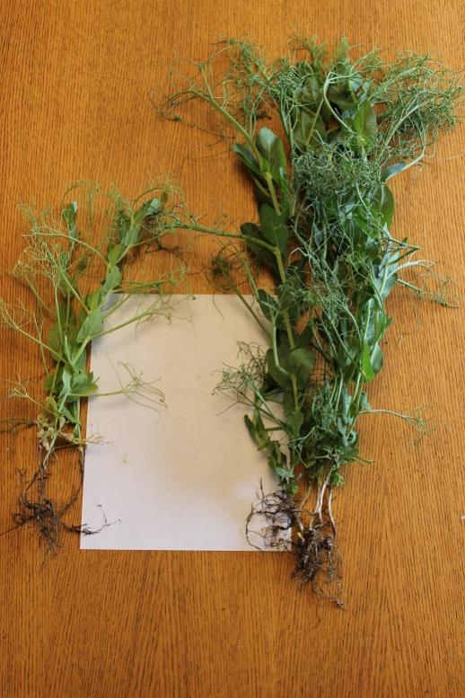

              Here are pictures of our peas. The really bad ones are BY FAR THE EXCEPTION, very small patch that is sick but I think I am beginning to see browning off of the roots of the healthy plants. The 8X11 paper in the one picture is for height reference. If they are going to slowly deteriorate it would be a shame, such a nice stand at this point.

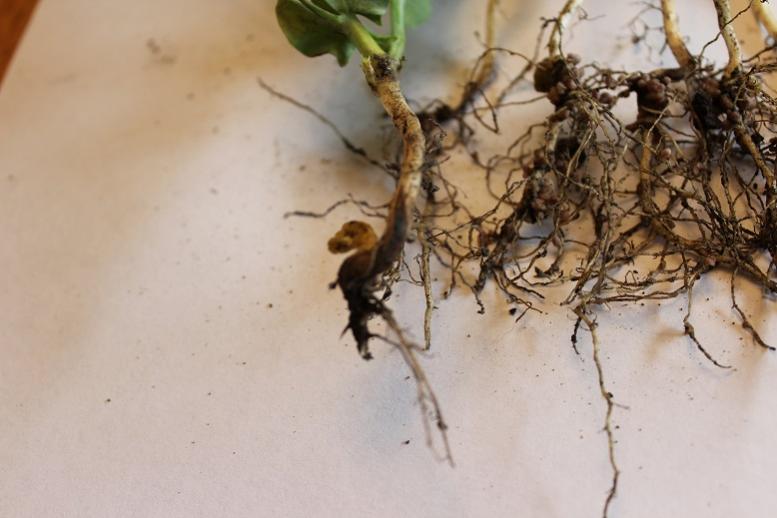

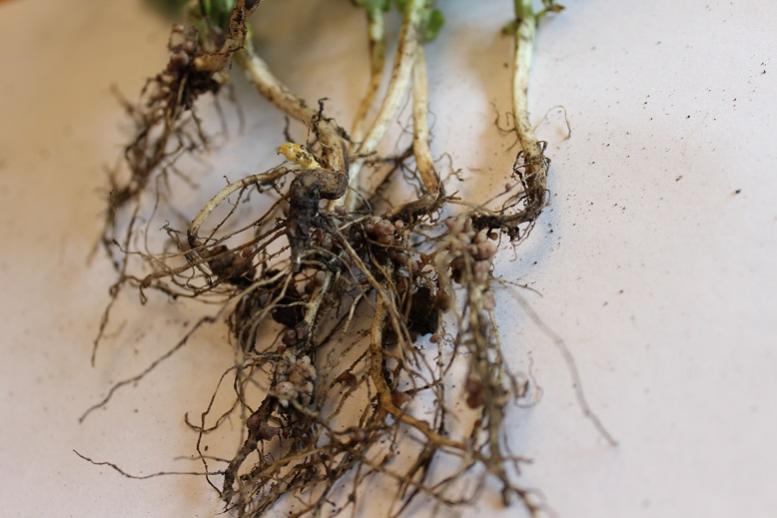

                • 17489
                One more close-up.
                I saw one flower and was thinking about going in soon to spray them for ascochyta/mycosphaerella.
                Am I wasting my money?
