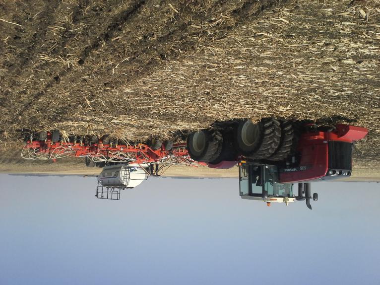

    • 17489
ID:	764910Click image for larger version
      • 17489
      Lol, belly laugh. New site learning curve issues.
      Can't go a season without getting stuck once.
      Cat tails sure sign of too wet.

                    fj, shouldn't have tried to get through that spot. Cocky because we drove through almost everything else! What a difference .78 inch of rain makes...stuck right away ;-)
