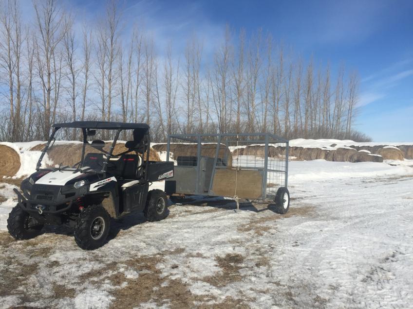

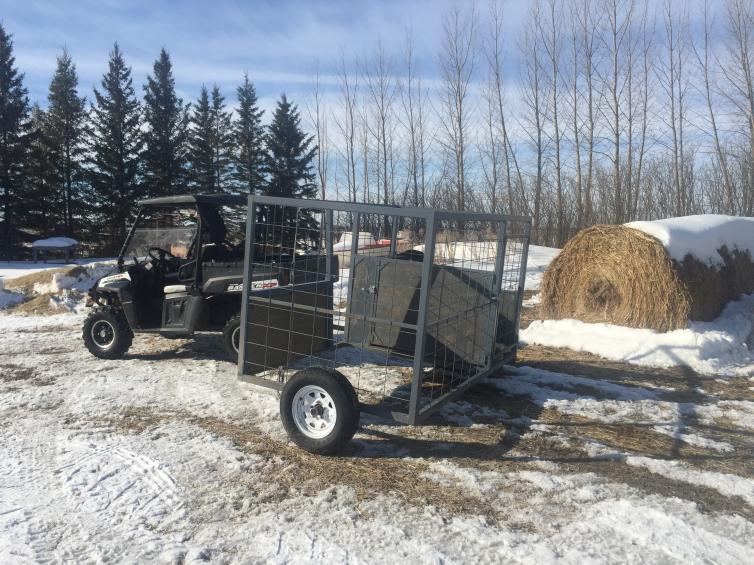

                  We picked up a calf catcher this winter for that I found on Kijiji.. it is a Soderglen Shark cage. I liked the design of it as I can unhook it in 30 seconds if need be, as far as safely goes we still are possibly dancing around the SXS with the cow but I'm pretty confident it will work ok. Seem to be having troubles posting pictures so this might not work so well ?

                    Here is the other Click image for larger version
