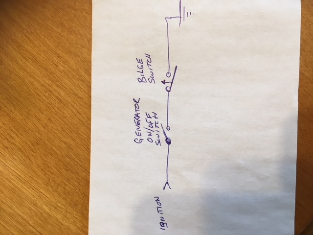

          I believe a bilge pump switch used in boats to turn on the pump when water level gets high enough should work for you. You have to look at it in the reverse of normal applications as the generator ignition control grounds out the circuit to shut the motor off so if this switch is wired in series in this circuit and when the water level rises to the top the switch would close completing path to ground.
          Here is a link to a catalogue showing a sample of a switch. http://online.fliphtml5.com/jgvg/htrk/#p=201
