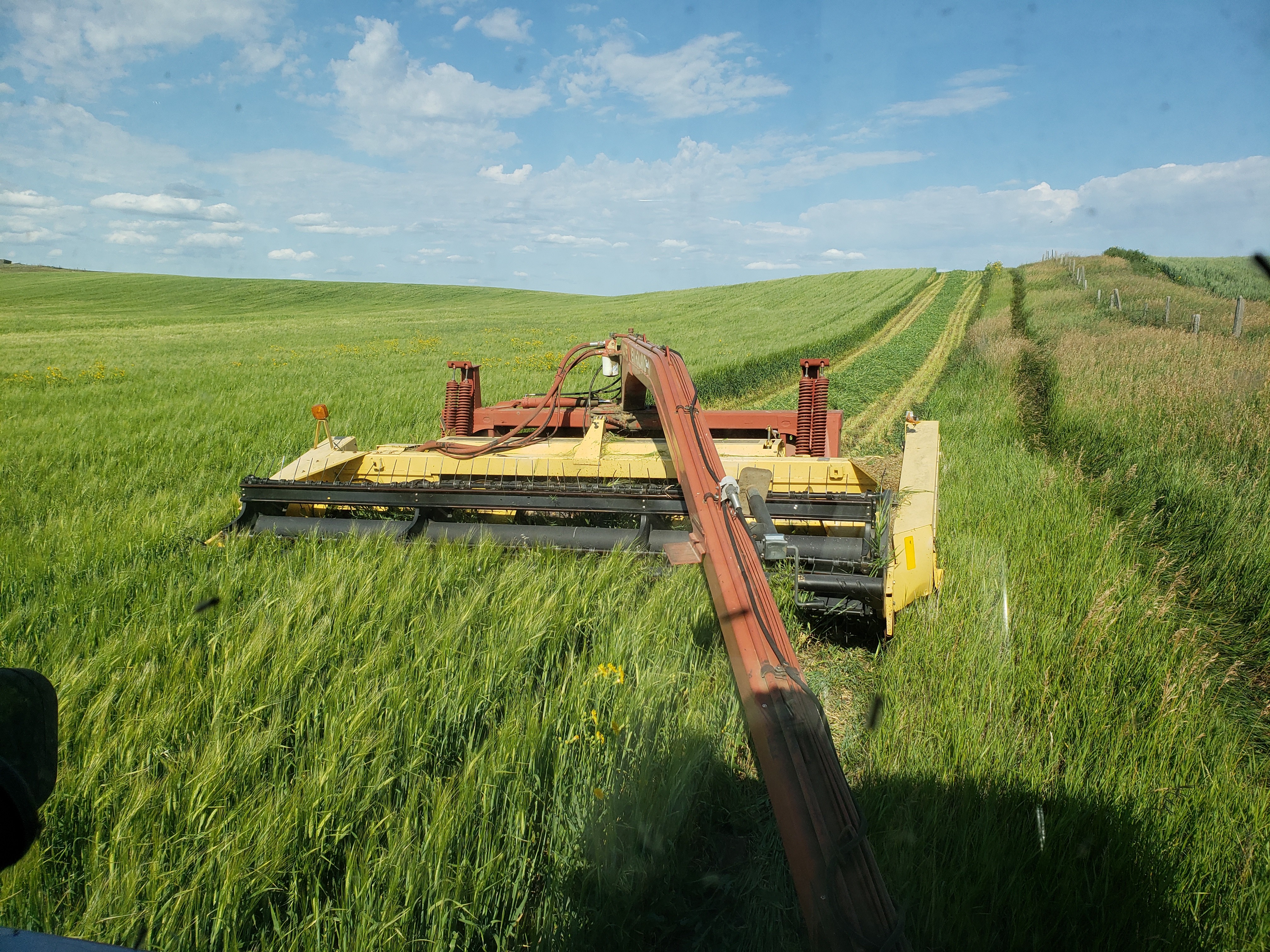

            The swath was laid out 6 foot wide and the canola kept it fluffy and it wasn’t lodged much so the stubble was kept longer. I find in heavy crops if the machine stays under 6 mph it leaves a ruffled swath compared going faster and laying a flat swath like a swather would.

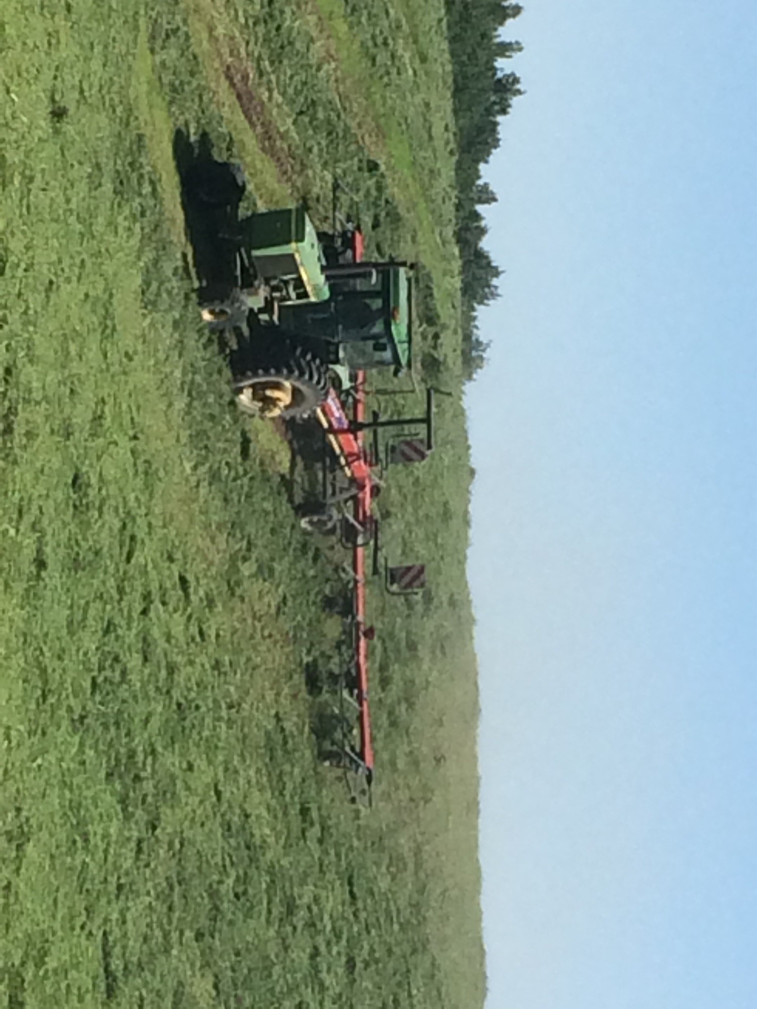

            Spreading two 19 foot swathes the day after it was cut allowing the ground to dry a little.

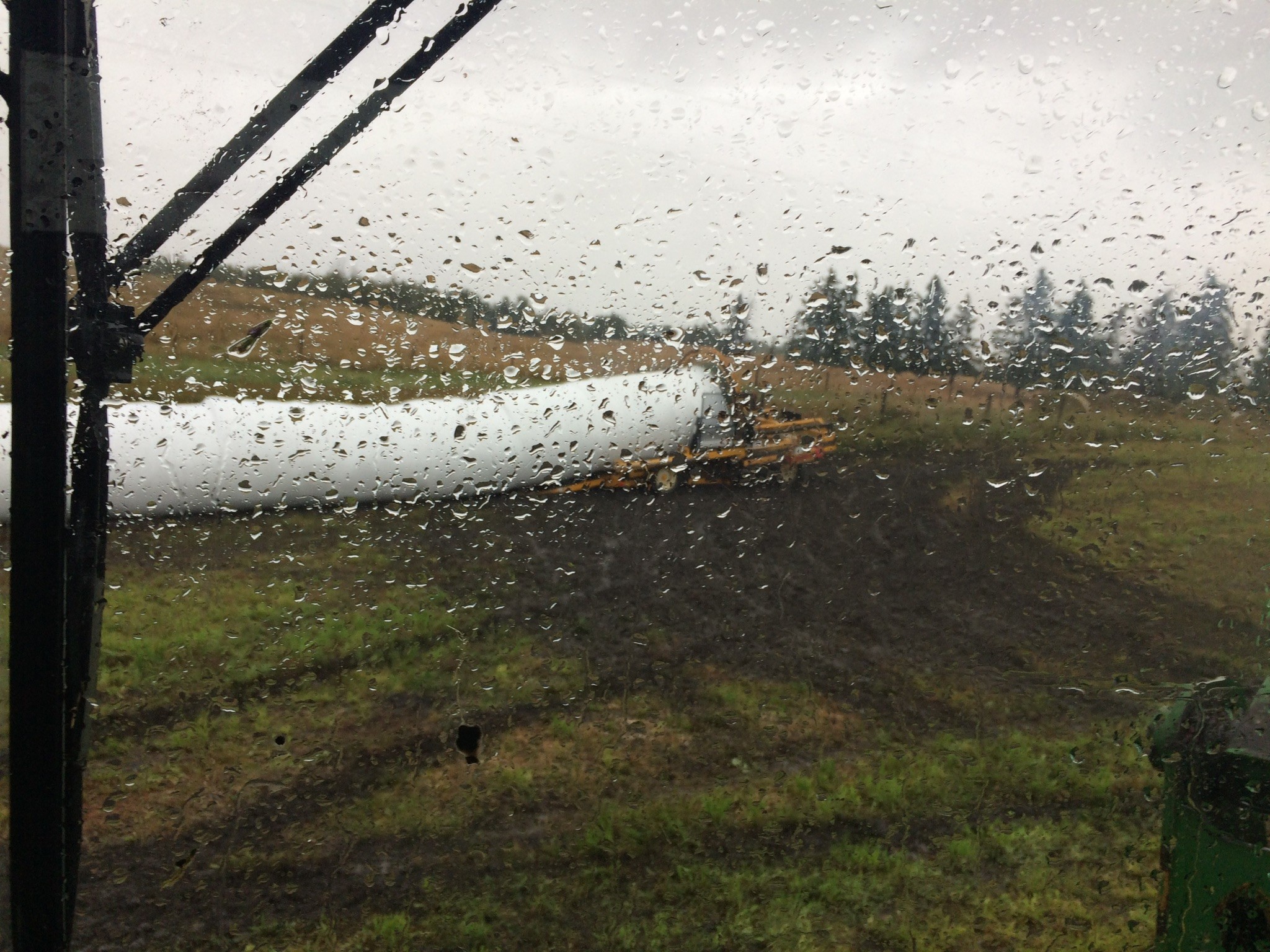

            Raked, baled, and wrapped 150 acres of beautiful 40% moisture second cut through the night and finished in the morning. Planned on dry baling it for sale but our week of sun changed to snow instead.
            Later after we finished wrapping that day.
