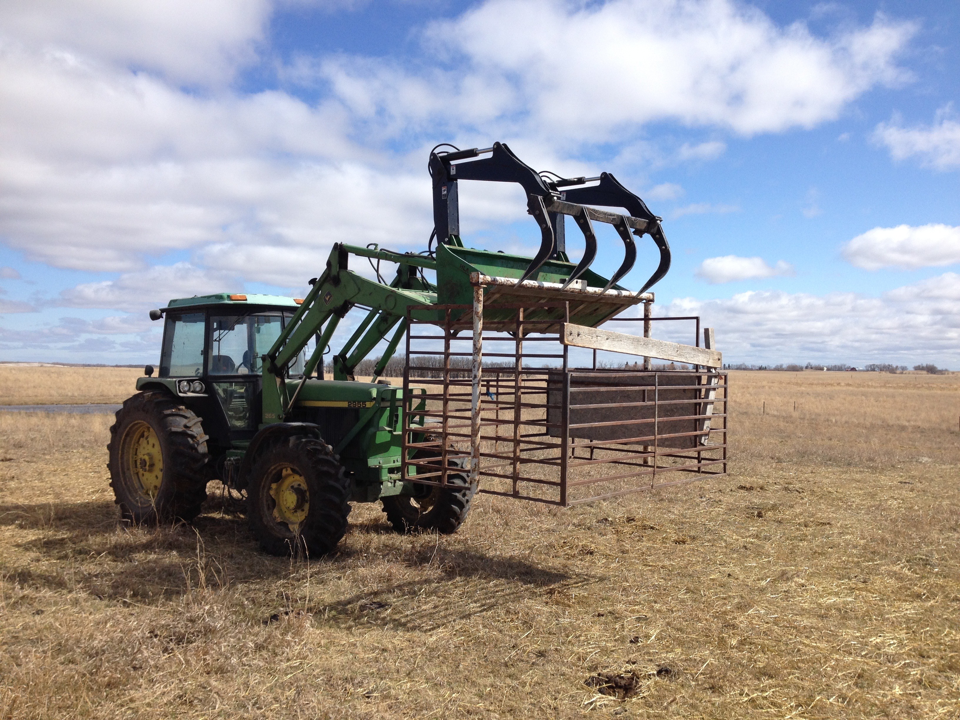

            Our solution to protection while tagging is this modified stock rack - weld a lifting bar over the top then carry it with the loader bucket. Works very well in our situation doing day old calves in a field situation, maybe not a cowboy solution or something for the open range but it works for me. I have a little floored area at one end if you need to take a calf home with the mother following. We don't really need it on most of the cows but I tend to use it anyway - as an attack survivor I've learnt to be cautious lol.
            Got nailed a decade ago by a bought-in overly "ranchy" Angus cow - just trying to get close enough to see the sex of calf when she charged me out of the blue. What you wouldn't believe until it happens to you is the velocity a cow can achieve over 15 feet from a standing start. Her head hit my chest going like a train, right over me and she luckily kept going with calf on her heel and didn't hang around to finish me off - I was down and out with broken collarbone, cracked ribs and a nicked lung. The point of this tale is you guys relying on a baseball bats and such - I had a stick with me and believe me you don't even have time to raise it in this situation before she hits you.
            BE CAREFUL it is an extremely dangerous task - even if your cows are normally quiet you don't always know their state of mind. I had a newly calved heifer come at me last week - something that we normally never see with heifers - then I walked a little further and came across a coyote - I reckon it had been bugging the heifer before I came along and had her wound up.

              That's a great idea Grassfarmer, we just grab the closest bale feeder and drop it over the calf and ring and tag them. We had just bought out a small herd of angus cross cows and yes they seemed to be really calm that is until they calved... its amazing how fast you can back pedal when that cow has her head down and charging you. Had one really close call so now we just take the bale feeder all the time, I'd like one of those calf cages for our ranger but not willing to spend the $3500 on one just yet...
