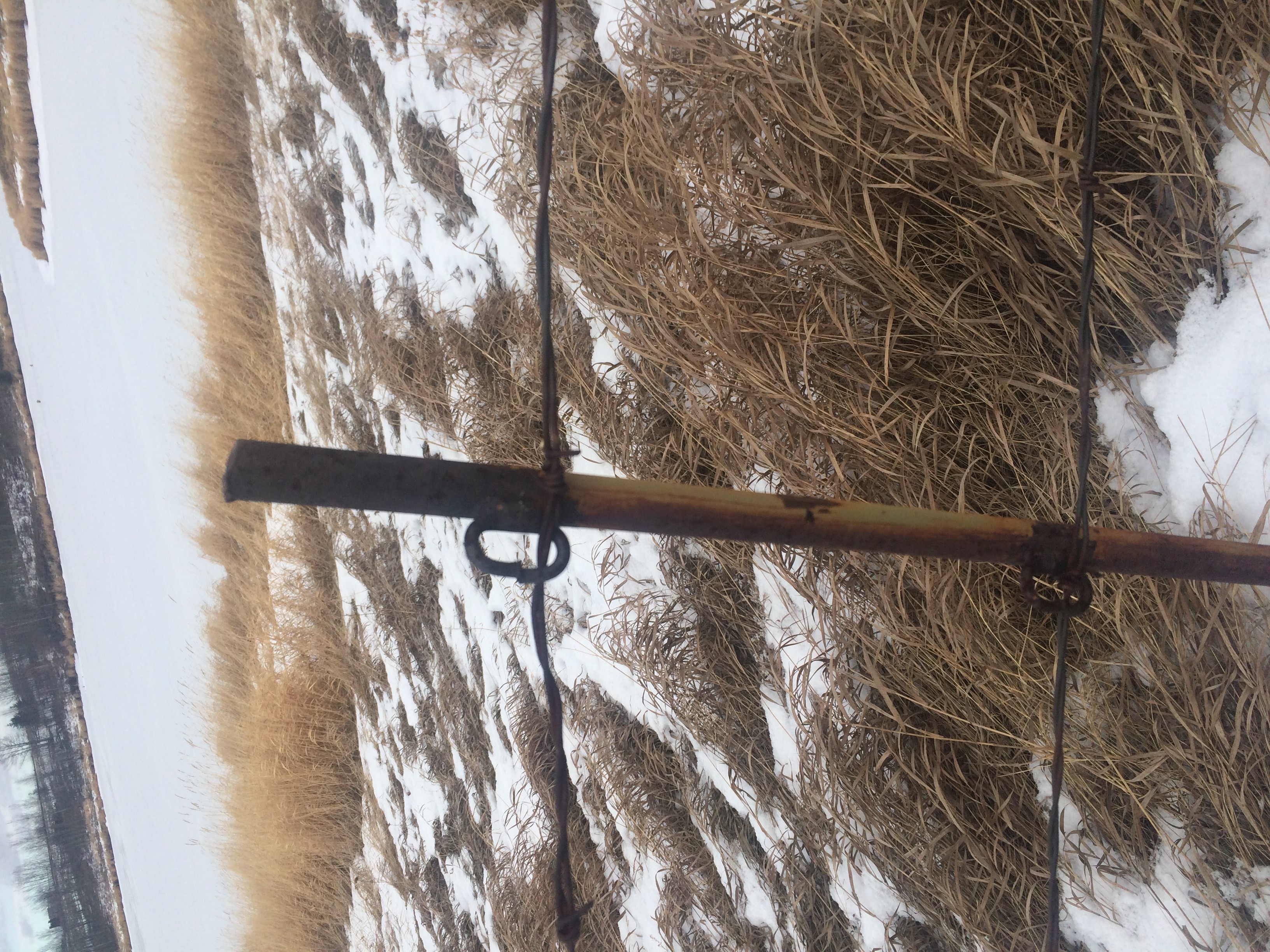

        We used to make sucker rod posts too. They were 8 footers to stay in the hills and low spots better. We took light chain and cut the links and twisted them open to put the wire in after welding them on. We got lots here from 20-30 years ago and you can still open the links up to change wire or pull the post and move it.
        We bought a bunch from the guy at drayton valley this year that makes them and I believe they were $5.75 for a six foot four wire with the twisted nails. They outlast staples here.
        This one is 20 years old and will likely get pulled and reused when we relocate the fence next year.

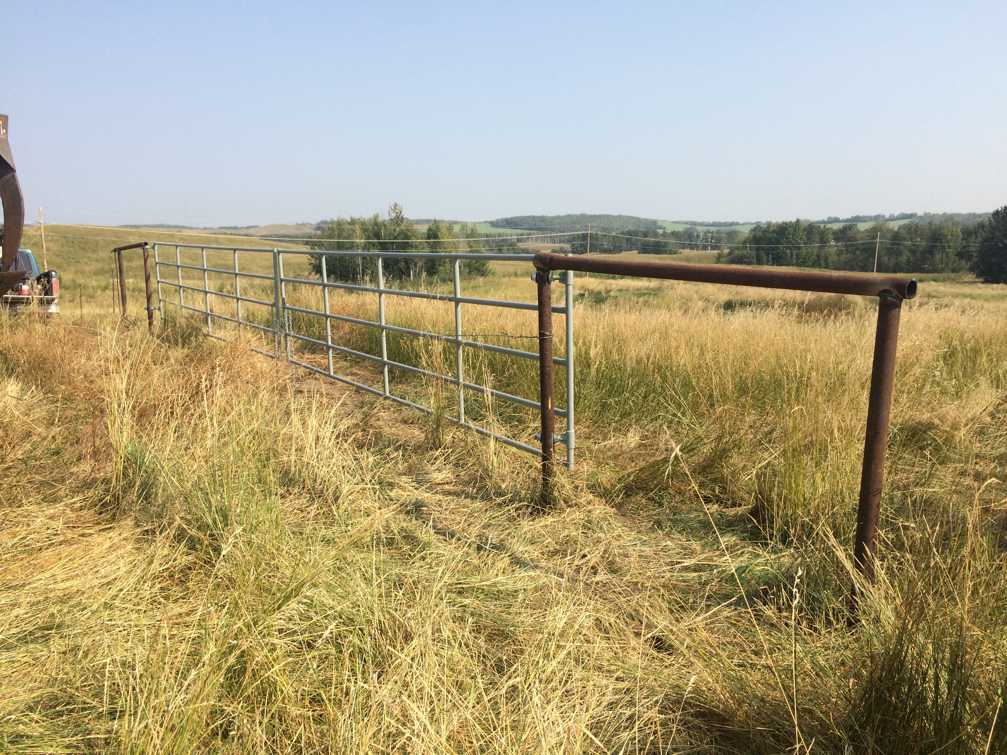

            We've never used polish rod as posts or braces so please "post" some pics. We just sink two 10' of 2 7/8" pipe and weld a horizontal and have decided to hang swinging gates so my folks and wife have an easy time using them. A few more dollars upfront but should save on maintenance and keep everyone including me happier 😎
            Two 18 footers so the combine header can fit whenever it gets rotated to grain.

              That looks great. When I do a pipe corner I’m usually alone so I do an N brace. Do enough you can trim out the brace not bad. With the polish rod I want it so I can set a corner quick and easy.

                Looks good....and I have finally figured out to put hinges at a 90 as well.....parallel with fence doesn't seem to last long before someone or something hits 'em>

                  We just use the welder and crank the heat up and burn the vertical pipes to saddle the horizontal and that way your length isn't critical. I do these while my wife is unrolling wire and just need a hand to hold the pipe while we use the loader or hoe to sink them.
                  I can stand on the end of a 18' gate and it hardly moves. Probably break the gate first. 😉
                  The low ground we sink ten feet with a female connector on the top end and thread another ten foot on the end of it and push that in. Those will still have the frost lift them very slowly.
