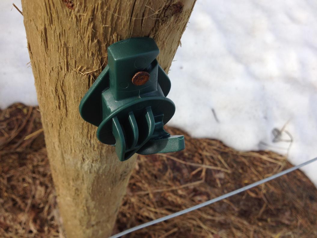

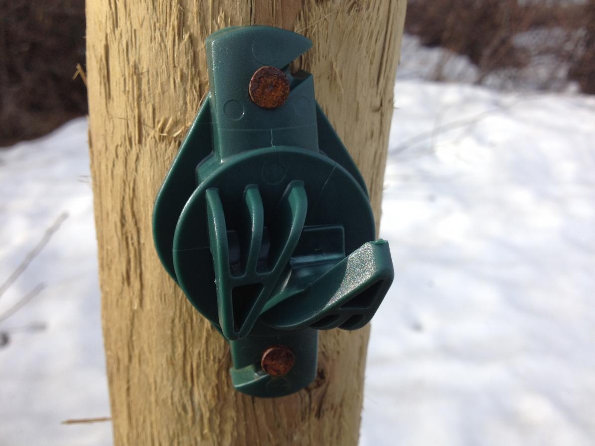

    I've always been a fan of Pel/Stafix/Speedrite electric fencing products but had a disappointing experience with Stafix claw insulators which I used for the first time last fall. Put up half a mile of fence along a treeline that was buried under some huge drifts all winter. Imagine my surprise on checking to find every claw insulator on that half mile with the bottom jaw hinged down and the wire lying on the ground. I normally always use pinlocks and the high and low posts were all done with pinlocks which held up. These claw type are just not up to the job. The dealer replaced them OK as they have a 10 year warranty but I'd rather only fence things once.

    I have never seen that before. I have seen aircraft cable that is unwound/rewound saw them off before but not bend them out. We use thousands of those same insulators. We have noticed issues over the last many years with cheaper insulators.
    I think with a lot of these plastic products (ear tags, insulators, car parts, baler twine, etc.) that the manufacturers change the recipe slightly for cost advantages or whatever other reason and the performance changes dramatically. We have noticed ear tags in some batches turn brittle or break more commonly in certain years of cattle (not just the oldest tags), and once we bought the really fancy Gallagher insulators for the extra money and they turn brittle from sun and snapped in half (broke in the collar behind the wire, not the tabs).

      I've seen similar ones do that as well. Can't say what brand they were as can't recall but they definitely didn't stand up as well as the odd pin type ones that were on the fence. However the pin ones also broke. Wire was too heavy gauge and the snow too heavy pulling it down. They just snapped or bent.
      No lack of work replacing insulators that spring! Lol
