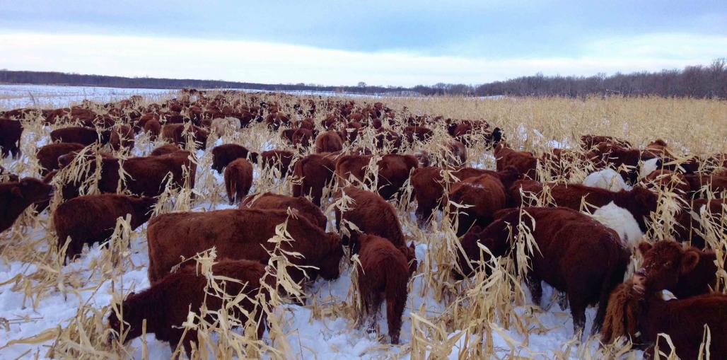

    Well we've been grazing corn for a month now and I wanted to share some experiences and see what more experienced corn grazers had to say. We had absolutely no trouble introducing the cattle to corn and they made an excellent job of cleaning up from day one. We have been strictly limiting intake as the corn is mature so they get a day at a time then every third day get alfalfa silage. It's been miserably cold most of the time they've been on it so can't say they have been fattening up. Calves are doing great but leaner end of cows have probably lost a bit condition. Biggest problem has been snow load as we've had over 2 feet with another 2 feet in the forecast for Christmas day! I understand these are unusual amounts for this area but it strikes me corn grazing isn't nearly as "snow proof" as bale grazing. About 1/4 of the field on the west side is drifted 4-6 feet deep and like concrete. Can't push through it to crossfence, cows can't access that corn till spring where we'll presumably have to cross fence it all again to limit access. Some people I'd read swath their fencelines before winter but I can't swath more than a couple days ahead or the fences get drifted in and you have to re-clear them. We are not getting the days expected per acre based on yield clips we took and it's not because we are leaving a lot behind. Seems to be a disappearance rate beyond what we can explain. One thing for sure the guys selling seed that claim huge days/acre by dividing tonnage dm by # of cows and days with no allowance for wastage are doing the sector a big disservice. That said it's still economical feed - looks like around $1/day cash cost per cow equivalent and I like the fact that you can go drop a fence on snowshoes if you have to during a bad storm and the cows are fed.
