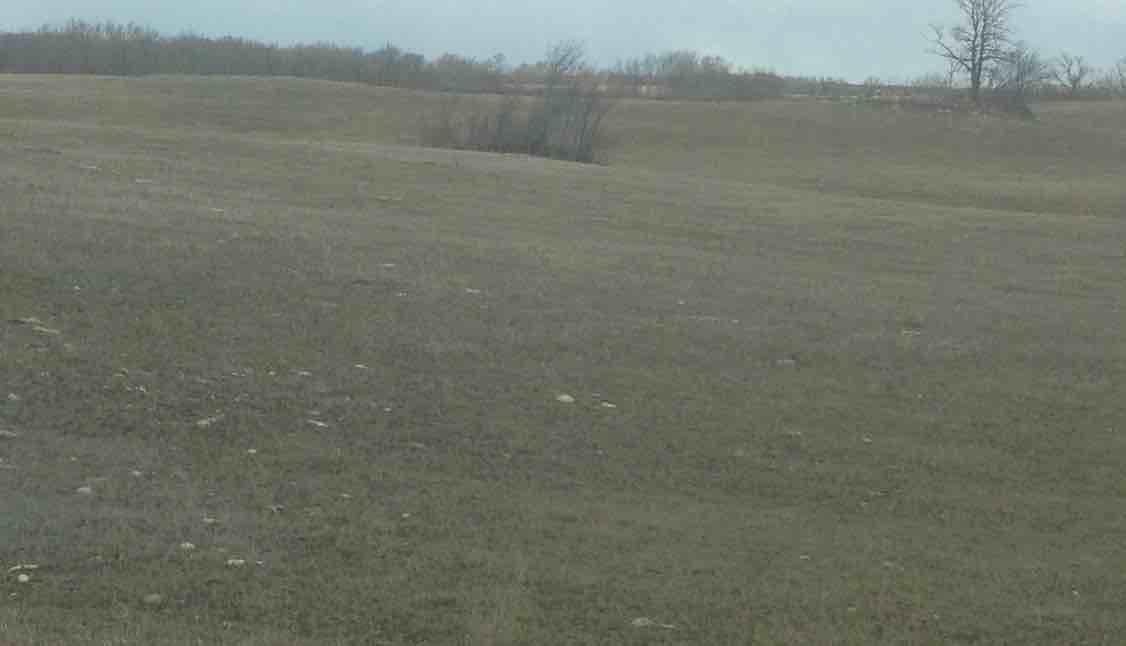

    Looked like this when I first bought it.
    We grazed/fed on it late winter into April this year and haven't touched it since - only the manure patches are over 6 inches tall.

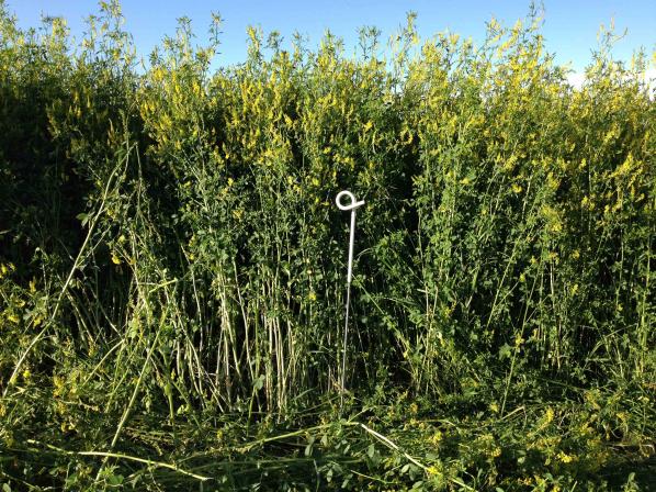

        Sean, its all the Norgold low coumarin variety so shouldn't have any bleeding issues. I really like what it does here but my only reservation is that it does too well - having to clear paths to cross-fence pasture like it was standing corn would be tiresome.

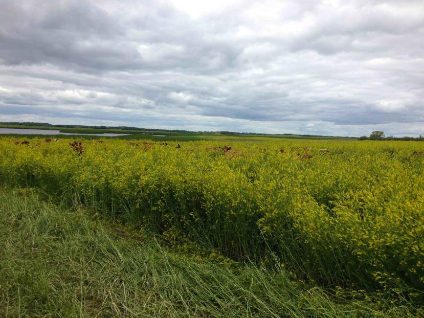

          120 yearlings/fall calving pairs in here somewhere!

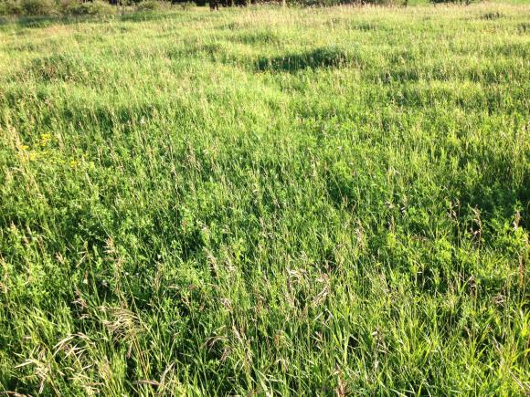

          Biomass production in the second year with sweet clover is huge - I'd guess as much in this one crop as the field had grown in total over the previous decade with "conventional" grazing management.

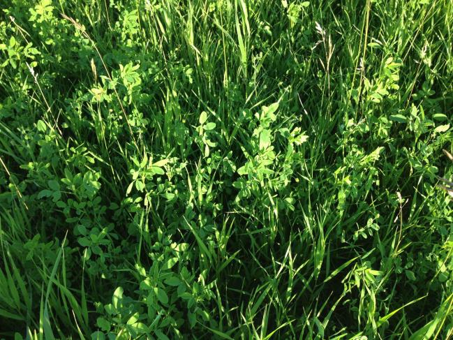

          What impresses me most is the vigor/height of the grass plants (at right) in amongst the clover. Same plants that were producing next to nothing even last year.

          Like anything it's not the complete solution. It offers a bale grazing type effect that we can apply across more acres more uniformly at less cost. Downsides are the need to plow paths through it to put cross-fences up rather like corn grazing. We are limited how many acres we can graze this time of year given how high the yields are. Won't always get a catch like this - we have 2 years out of 3 but with a very dry spring the germination was very poor on the patch we seeded this spring.

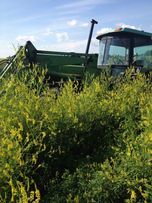

              Is that an electric tractor Grass farmer or a dirty diesel left idling and heating the planet.
