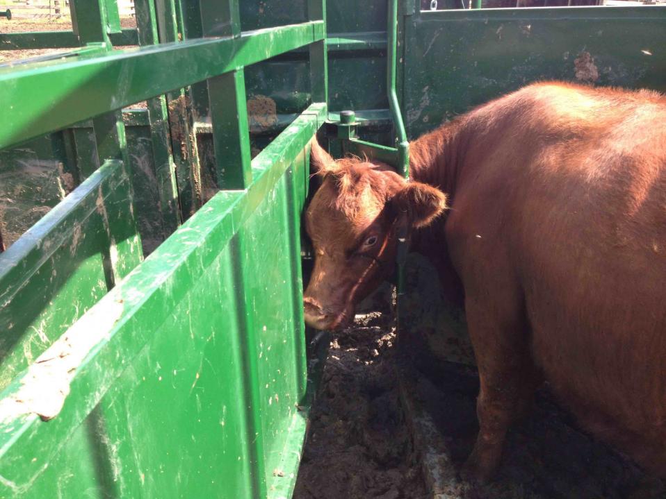

    I want to alert readers to a hazard we encountered on our Arrow crowding tub and I'm guessing it will affect the Lakeland ones too. A curious cow managed to get its head through the square on the tub door ratchet mechanism. Assume she must have done it when the tub door was open when the square piece extends beyond the door. Of course she couldn't get it back out so I had to cut some metal to release her. The company has been informed about the hazard but I'd suggest if you have one to just plate or otherwise cover the square as that would be way easier than extricating a cow. Maybe its a one in a million happening but I wouldn't want to chance it when there is such an easy fix.
    [ATTACH]428[/ATTACH]
    Looks like she loaded your alley anyway lol. Serious flaw but not deadly which is good.

              Mine has a cut in the 2 x 2 horizontals in your picture...somehow she got her head in sideways and couldn't get it out...still want to change to a bud box, but haven't gotten there yet....
