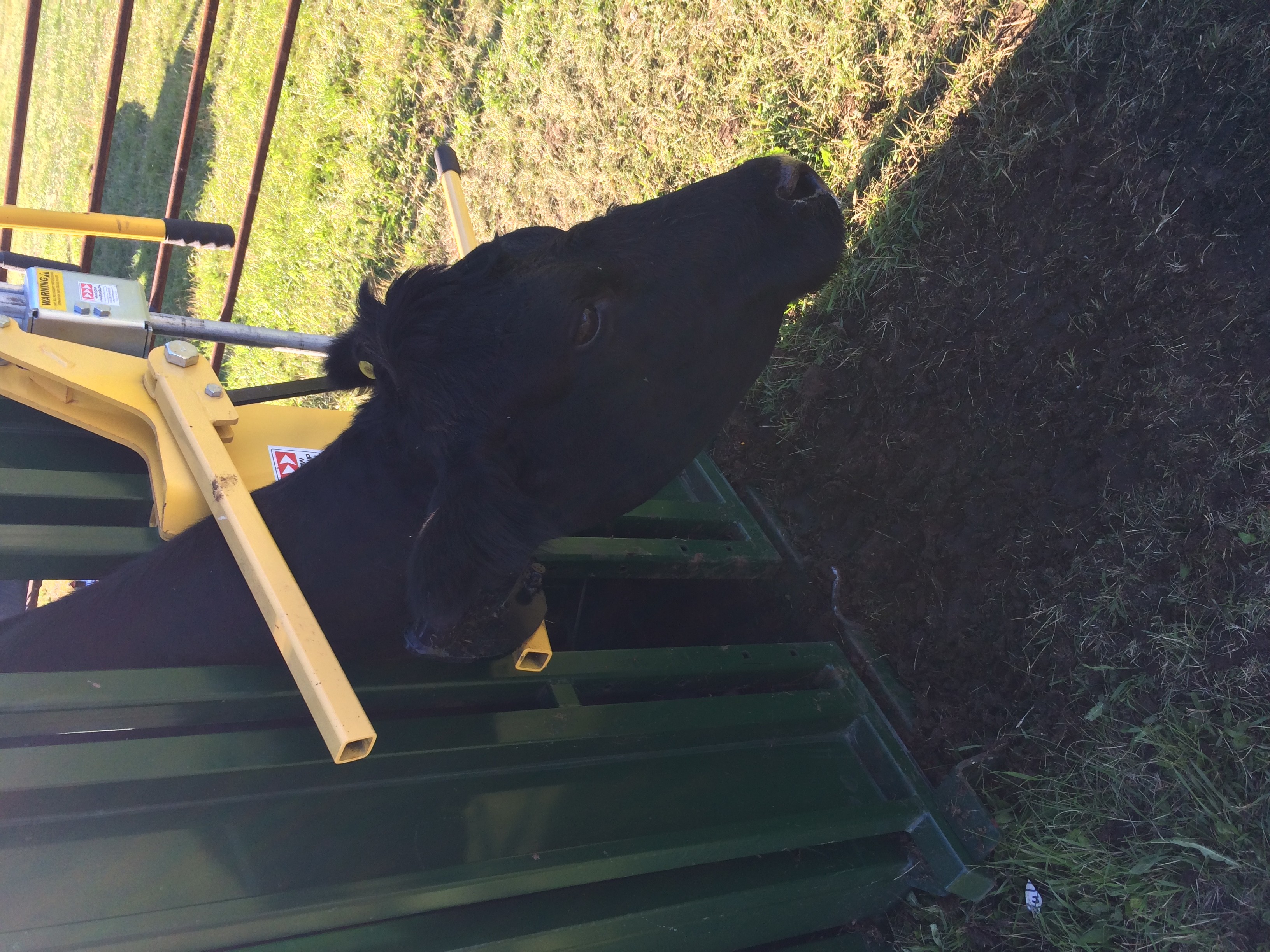

        Thanks for pointing that out grassfarmer as ours is the same design. Ours has the scissor in front of the head gate and it works great. It's adjustable vertically and the only picture I've got of it is with a cow and it's set too low. When we brisket tag bred heifers we could 30 an hour with haltering each one. Now we do 45 an hour without a halter.
          #44
          I should have gone with that neck option but I just thought it looked so clumsy and the handle is something you'd be tripping over. When we go to tattoo yearlings or big calves they just drop to their knees and the head goes right to the ground even underneath the neck extender bars. So with the neck held in this scissor deal what happens if they fall to their knees or do you use a sternum bar?
            • 1973
            #45
            Occasionally the heifers will go down after catching their head. Sometimes you can still tag them if their hide is loose or else you release the head and sides and they should stand up. Had the same problem with haltering anyways. We had a sternum bar in our stampede hydraulic squeeze and sometimes they would get legs on the wrong side of it so we removed it. I've got to think it's pretty hard on the animals to put weight on it when they do go down. Also can't run small calves through it with the bar installed.
