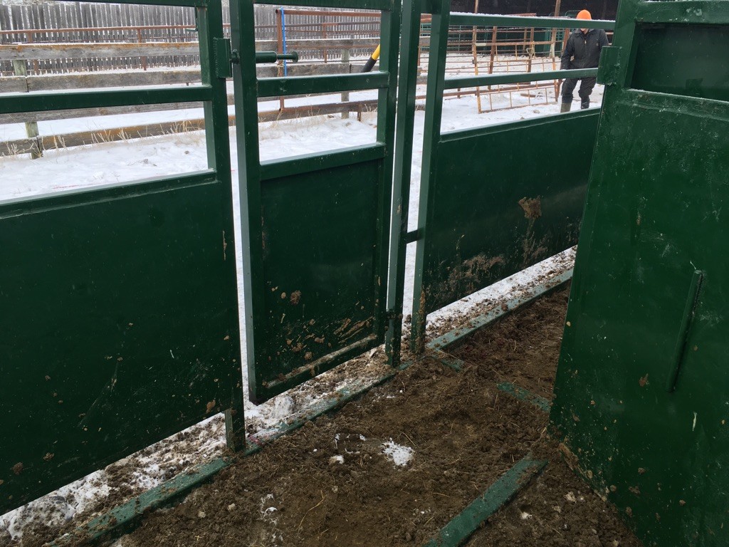

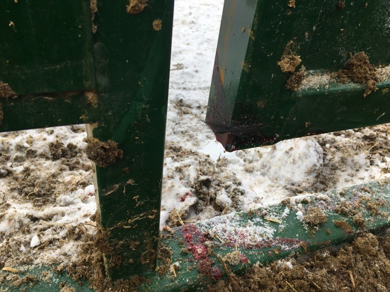

                      We purchased a arrow squeeze and portable tub and alley combination last fall. The squeeze worked great especially the head catcher for brisket tagging the bred heifers. The tub and alley worked fine as well however there is a design flaw with it. There is vertical square tubing that ends about a foot above ground and is sharp enough to cut a leg to the bone if an animals leg slips out and is pulled back up by the animal.
                      This is a picture of where it happened on ours.

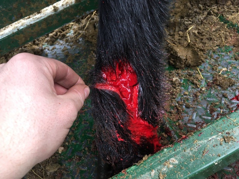

                      And the damage to a perfectly good bred heifer that we stitched up but weren't able to save since it froze up and got infected bad enough that I put her down.
                      The retailer was very helpful and passed along the information to the company and said that arrow's territory manager would contact me to discuss this. It's been two weeks and all that's happened is they mailed some plastic plugs to put in the tubing. Still awaiting to talk to someone. Thought pretty highly of them till this happened and we've only run 700 head through this setup. Just a warning to anyone with a similar system to check it out.
