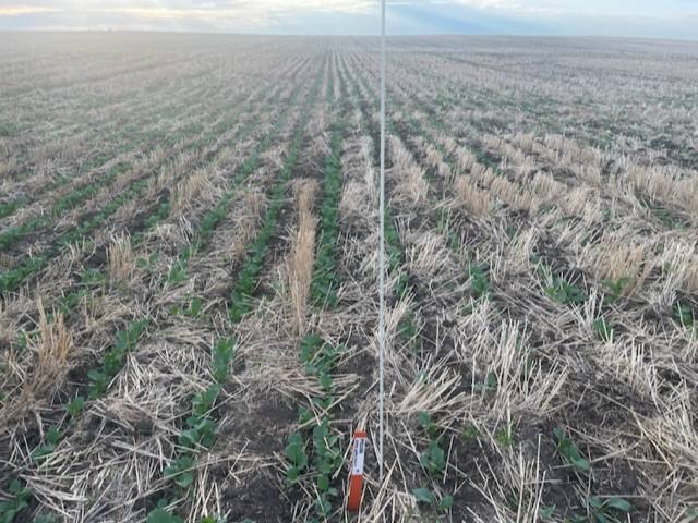

May 31, 2023 | 16:01 1 Wheat seeded May 15th .. with bourgault

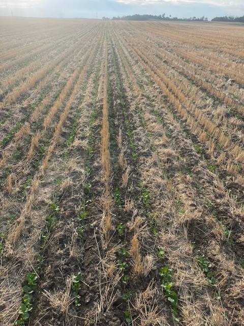

Canola seed rate trial with SM SR
2.5 lbs
3.5 lbs
Will update photos in about 10 days Reply With Quote

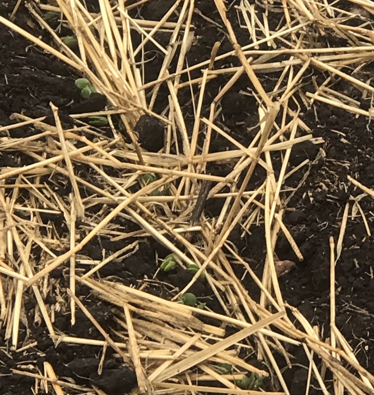

    blackpowder's Avatar May 31, 2023 | 19:57 3 Have any pics of SR in trash? Reply With Quote

    May 31, 2023 | 21:58 5
    Quote Originally Posted by blackpowder View Post
    Will get much better ones in the nest few days
    Been busy as hell last 10 days Reply With Quote

  • Jun 1, 2023 | 06:23 6
    Wheat stubble not harrowed ..
    Reply With Quote
  • 1 Like
  • Jun 1, 2023 | 06:50 7 Different field, still wheat stubble not harrowed
    Seems to be ok , just out getting the last of the rock ridges finally..
    I really like this rock bucket Reply With Quote
  • 1 Like

    Jun 1, 2023 | 15:59 19
    Quote Originally Posted by furrowtickler View Post
    I really like how black the seed row is. My bourgault 3320 seems to cover the seedrow in straw and emergence is very slow. That black, warm seedrow just pops out. Is it the drill or are you protilling or heavy harrowing to get your residue levels so low, or does your 12" spaced drill just have that much less straw to deal with? Deere salesman claims the 12" conservapak will have less straw, the same yield and harvest quicker than my 10" Bourgault. Would be nice if it is true. Reply With Quote

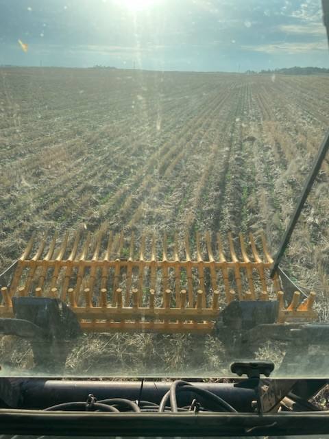

    blackpowder's Avatar Jun 1, 2023 | 19:16 21 Yes, I'm beginning to question more investment in straw management.
    The catch for me is to afford enough hydraulics to make the SR work.
    Always something. Reply With Quote
    Jun 1, 2023 | 19:42 22
    Always something.
    It started at harvest , the New Hollands have great choppers and spreaders . We cut short , drove a bit slower but It paid off
    Very little hydraulic required for the SR to be honest when set up with liquid Reply With Quote
    Jun 1, 2023 | 20:34 23 And yes the trash cleaners “look” Mickey Mouse and did give us some minor grief, but 80% of our canola was direct seeded into untouched wheat stubble at 300 to 400 ac / day . Not bad for a 60 ft drill . And we never pushed hours once
    Reply With Quote

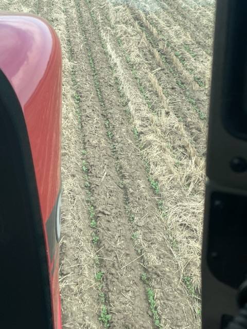

    Jun 1, 2023 | 20:51 24 Geiko soybeans seeded May 23.
    1870JD Conservapak 12”
    3.5mph.
    Degelman Rolled
    Will be interesting experiment!
    Enough moisture to settle the dust today….
    2” behind normal rain fall.
    Praying for rain!!!

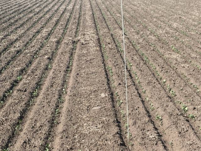

    Jun 4, 2023 | 16:47 30 Canola seed rate trial
    2.5 lbs left
    3.5 lbs right
    On pea stubble Reply With Quote
