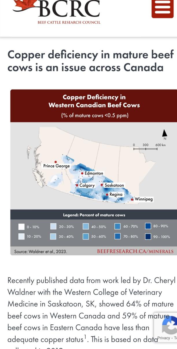

          50% to 70% of cows in western canada are copper deficient so you aren't in a unique area.
          I'm thinking a lot of those cows get free choice mineral?

                50 - 70 % Copper shortage in livestock, similar numbers with Magnesium shortage in humans. What does it cost to get a blood test for mineral deficiencies in livestock.
