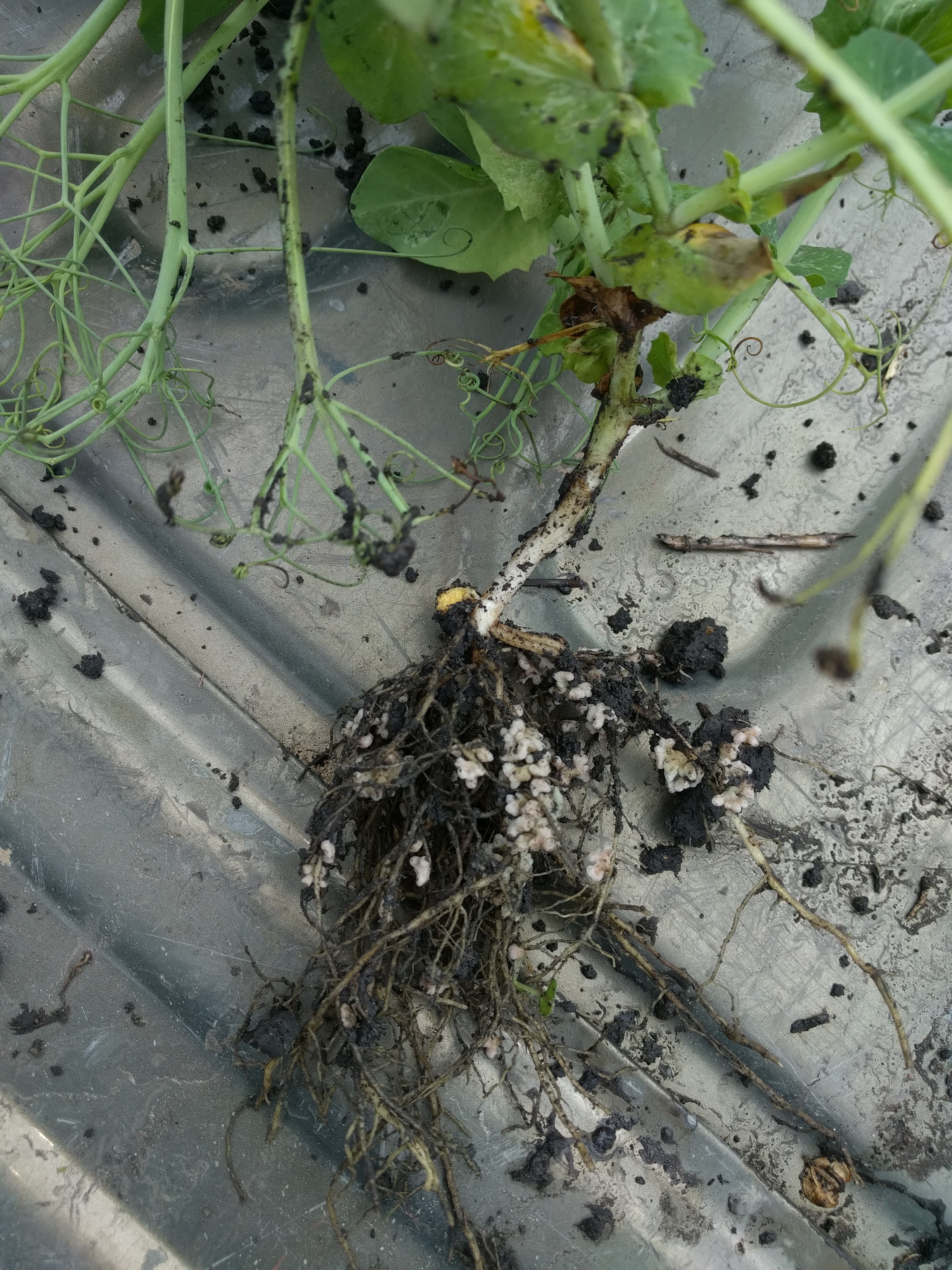

      I put no fertiliser down in the seed row. I banded 60lbs of straight phosphate 3" deep before I seeded, then another 25lbs of s15 in the fertiliser knife of a seed hawk. Plants look relatively healthy so I'm not sure if they are short of N. Should of taken a tissue test I guess.
      Since this thread was started comparing pea innoculation to soys, here are a couple pics of pea nodules taken a month ago. I have never seen Nodulation like this before, the nodules are massive and cover every root hair.

        Good pics Wheatking and nice job of cleaning those roots off. At the very least I could have dug some pea plants up and looked for nodules as well.
        Is that high grade coal on the truck end gate? ;-)
