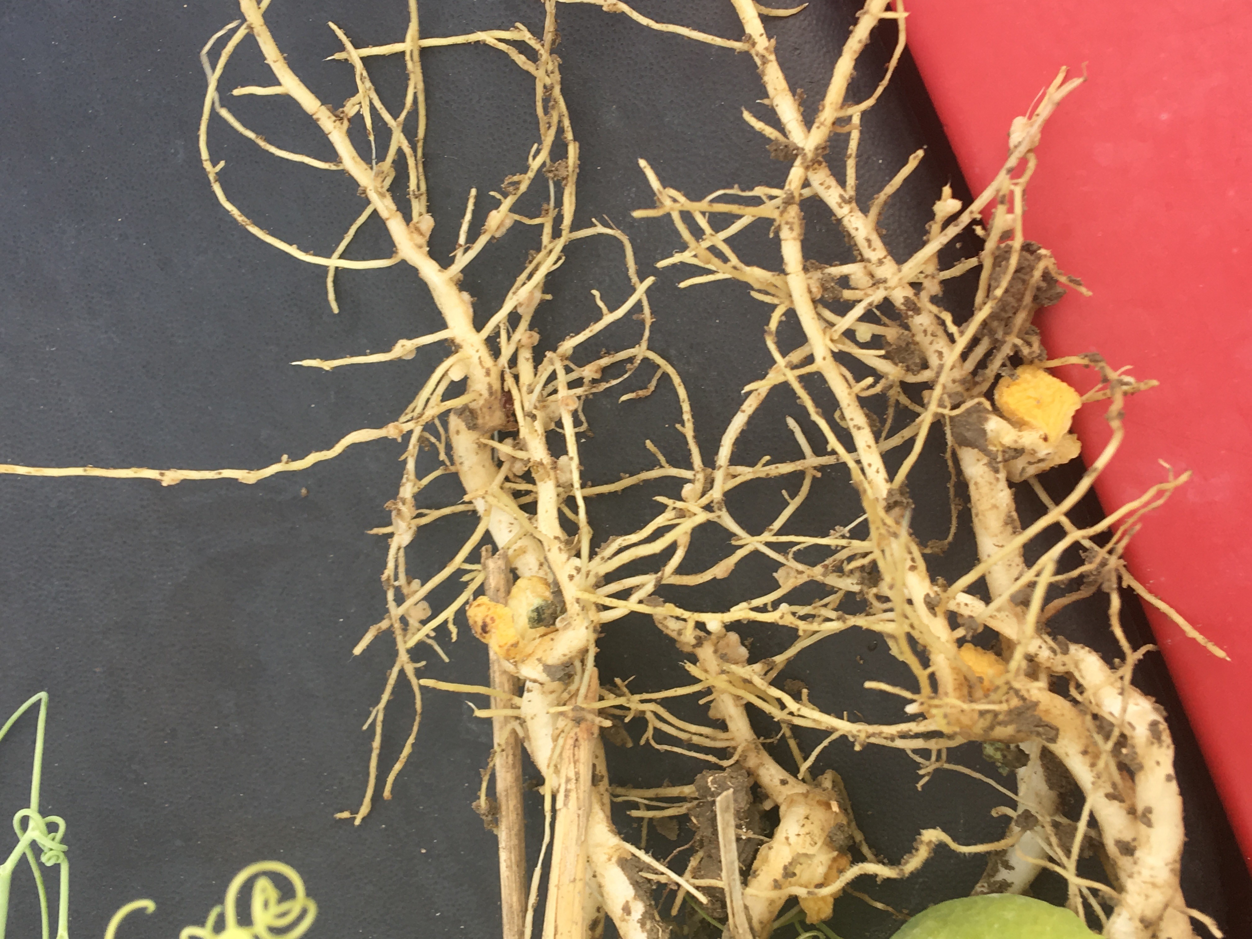

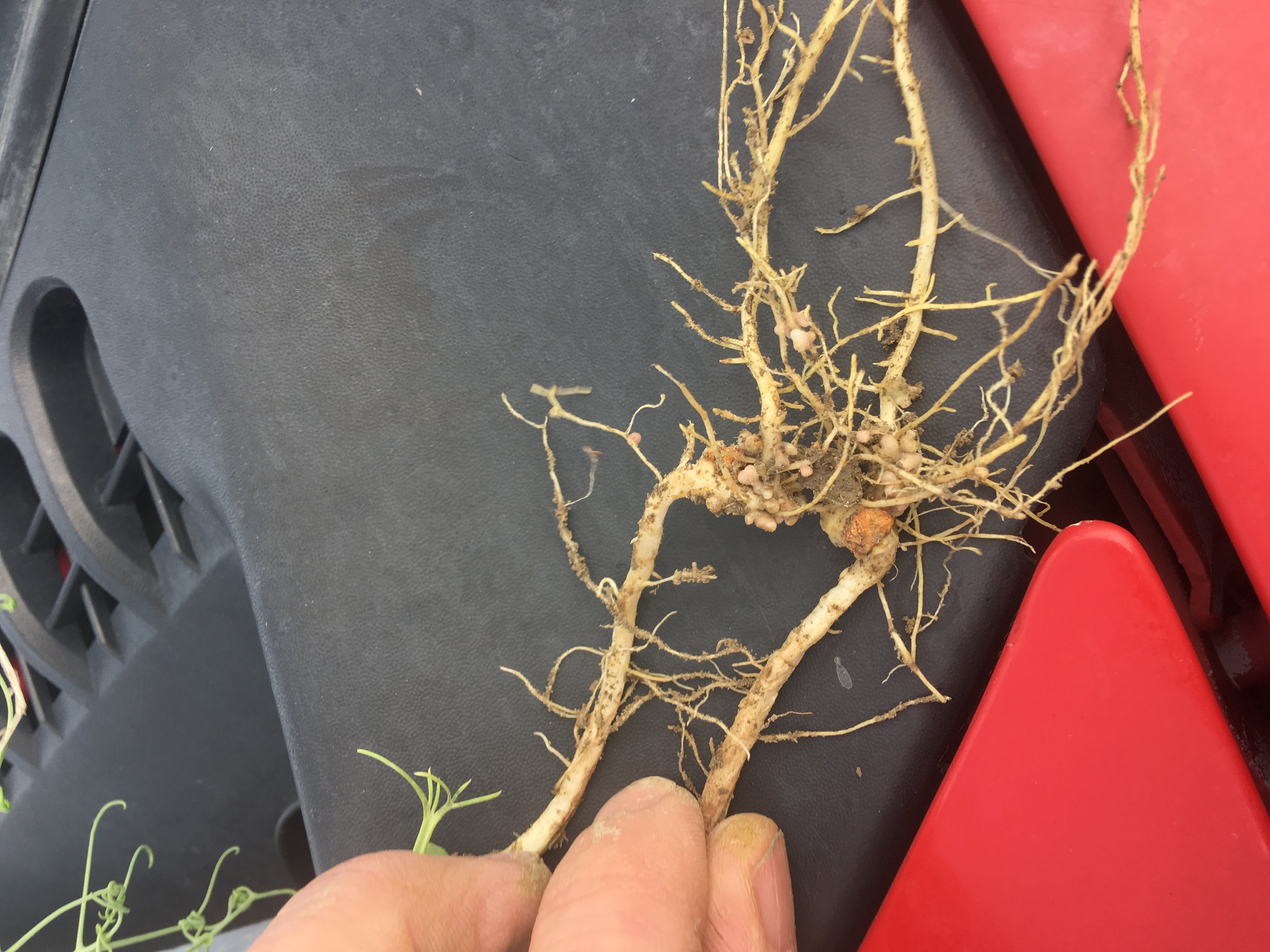

                  If it was good on lentil stubble and not cereal stubble i wonder if you don't have nitrogen immobilization in chaff rows behind combine. This will fix itself once the nodules kick in which seems to be happening right now on my peas. And once microbes run out of stubble to eat, they die and release the N back into soil and problem solved from either standpoint. But, this issue should really be on older pea leaves as mentioned above.

                    Nodules green plant

                      • 871
                      Nodules on yellow plant
