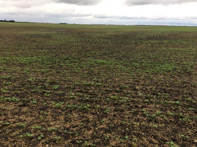

                  20 year old 5710 worth near ZERO...seeded at 4.2 lbs/acreClick image for larger version
                    #79
                    20 year old 5710 worth near ZERO...seeded at 4.2 lbs/acre[ATTACH]1555[/ATTACH]
                    looks good fj , but probably worth more than our morris maxim . bourgault has better resale , lol

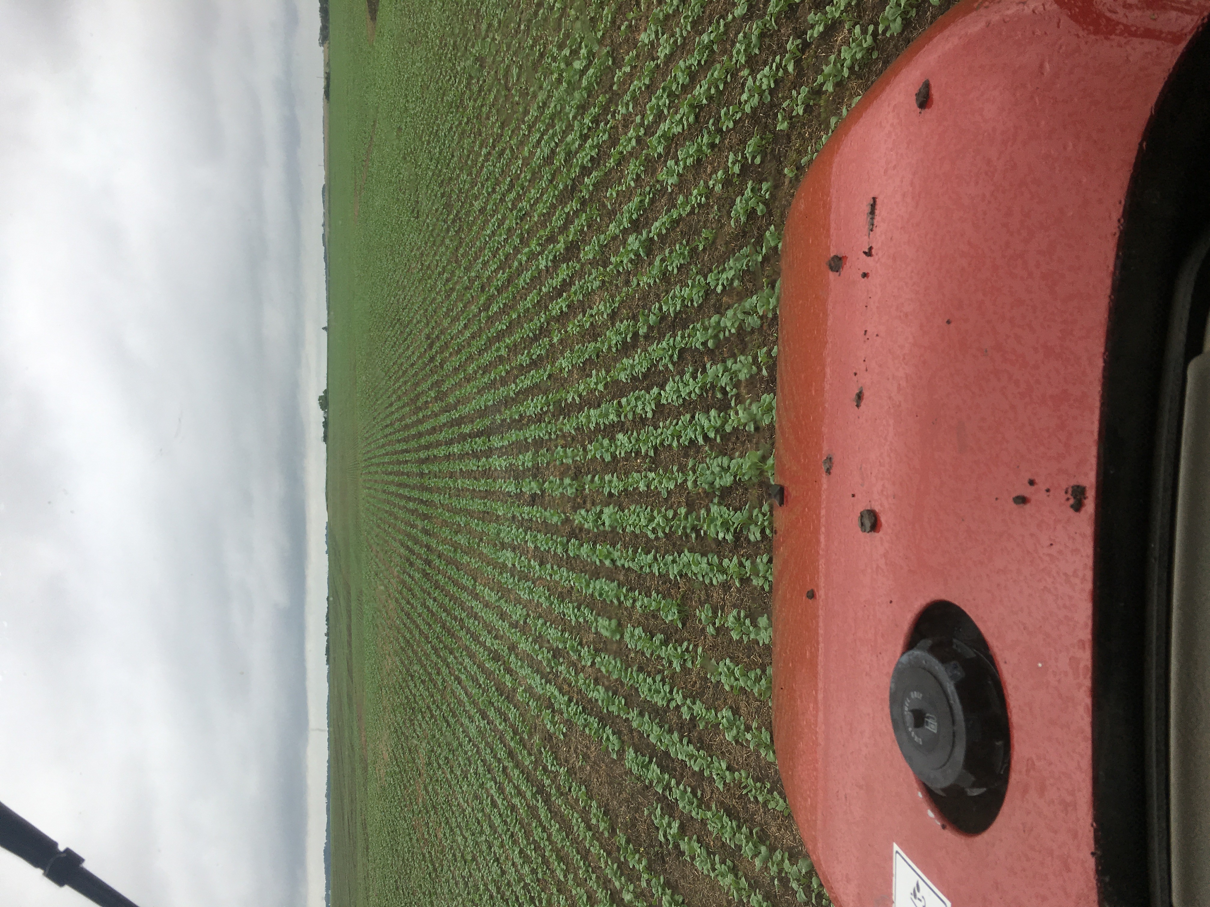

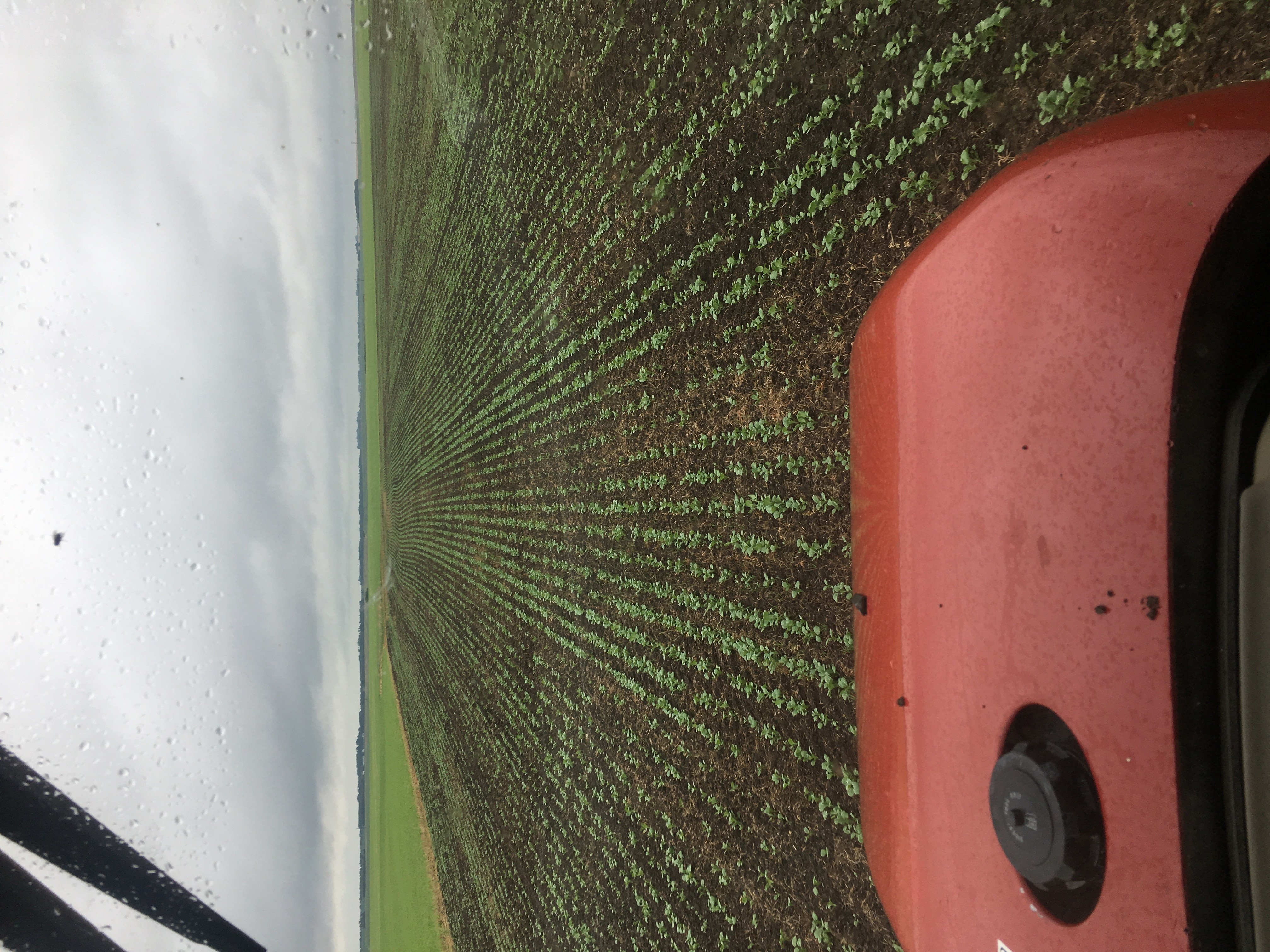

                      As of today, for those interested..
                      Here is our terrible, shitty canola seeded with our Bourgault.....4.7 lbs
                      And the canola with planter ... 2 lbs
                      Seeded same day .
                      Not saying the planter is the end all be all , just interesting at this point
