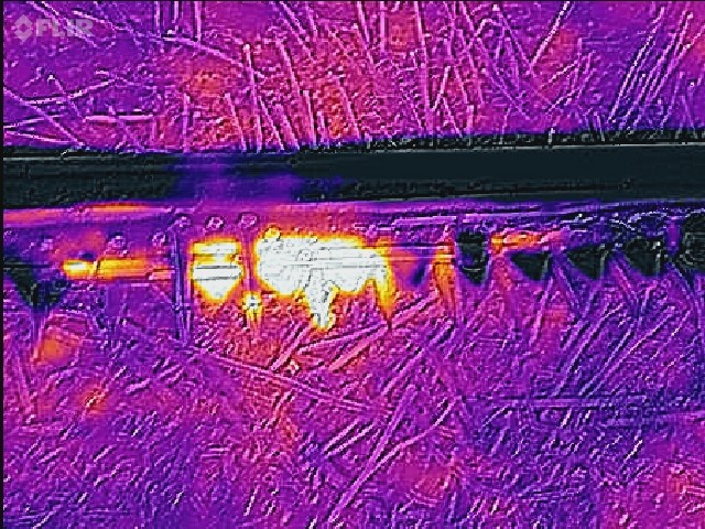

          The flir one that I used has two cameras one thermal imaging the other is standard. It uses the regular camera in daylite to improve image quality by providing outlines. In the dark its all thermal.
          I find it very useful for scanning for interferrance on the knife of a straight cut header or swather.
