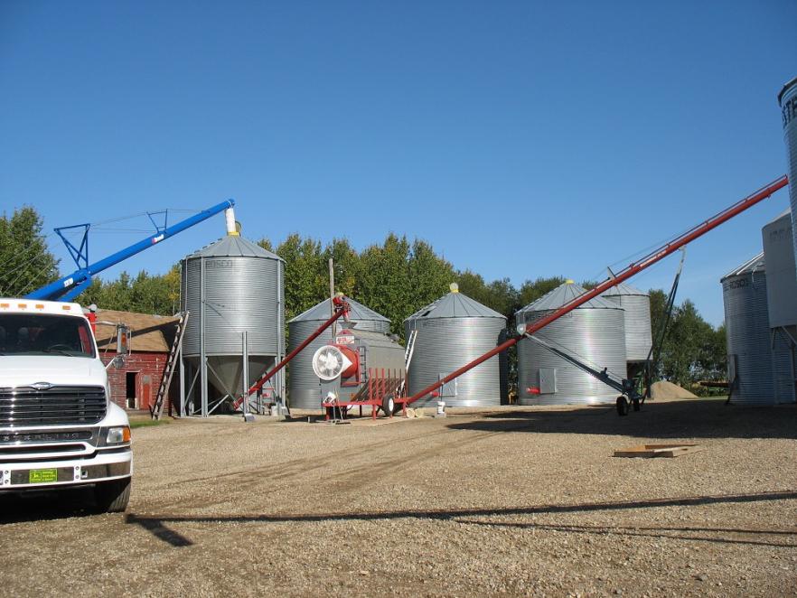

                    Ancient 1978 Farm Farms AB12B, converted to gas, means you remove parts and drill out orifice. Need a licensed gas fitter and Sask energy inspection. Dries every year when #1 wheat goes under 20%. Saved thousands in grade loss, adds harvest capacity, prevents any spoilage. Usually done drying a few days after harvest, all safe in bins. Been low maintenance, motors, bearings one flighting worn out, breakers and two flame switches. That is over 38 years. Also bought at Helgasons Foam Lake.Click image for larger version
