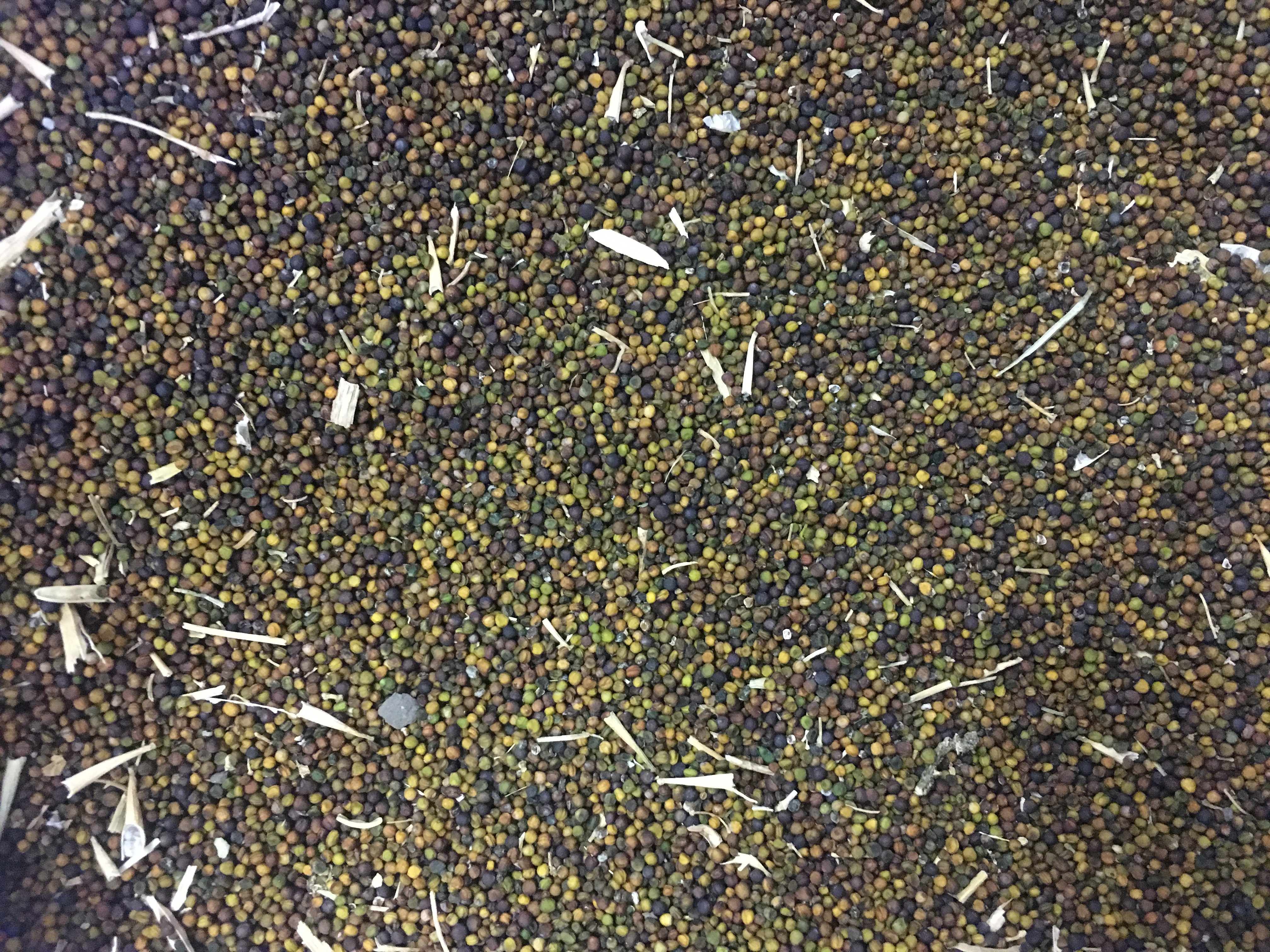

                The 75-65 we had in was less than stellar ....
                Granted it was seeded later and did have some frost damage , but does it always look like skittles ?
                Got close to dry on Monday so we took it off but the green stayed anywhere from 15-20% .
                Maybe under normal conditions it performs better .
                It seems like it can't handle fall frost very well .
                Maybe it was just our bad luck ......

                    BTW the sample looked exactly the same from the swath or from standing . So it was not a case of swathing too early .
                    There was anouther field NW of here seeded same day that apparently was good . Probably never froze like we did in early September, but not sure.
                      Had 7545 that looked like that too and seeded a bit earlier and swathed when colour was changing. 7444 black as night. Neighbour had 7565 besides me and it was great but later. Surprisingly the best yield was the worst looking crusted flea beetle eaten 1022 nexerra. Had good season here albeit late. Enough crop out still but most are done or close.
