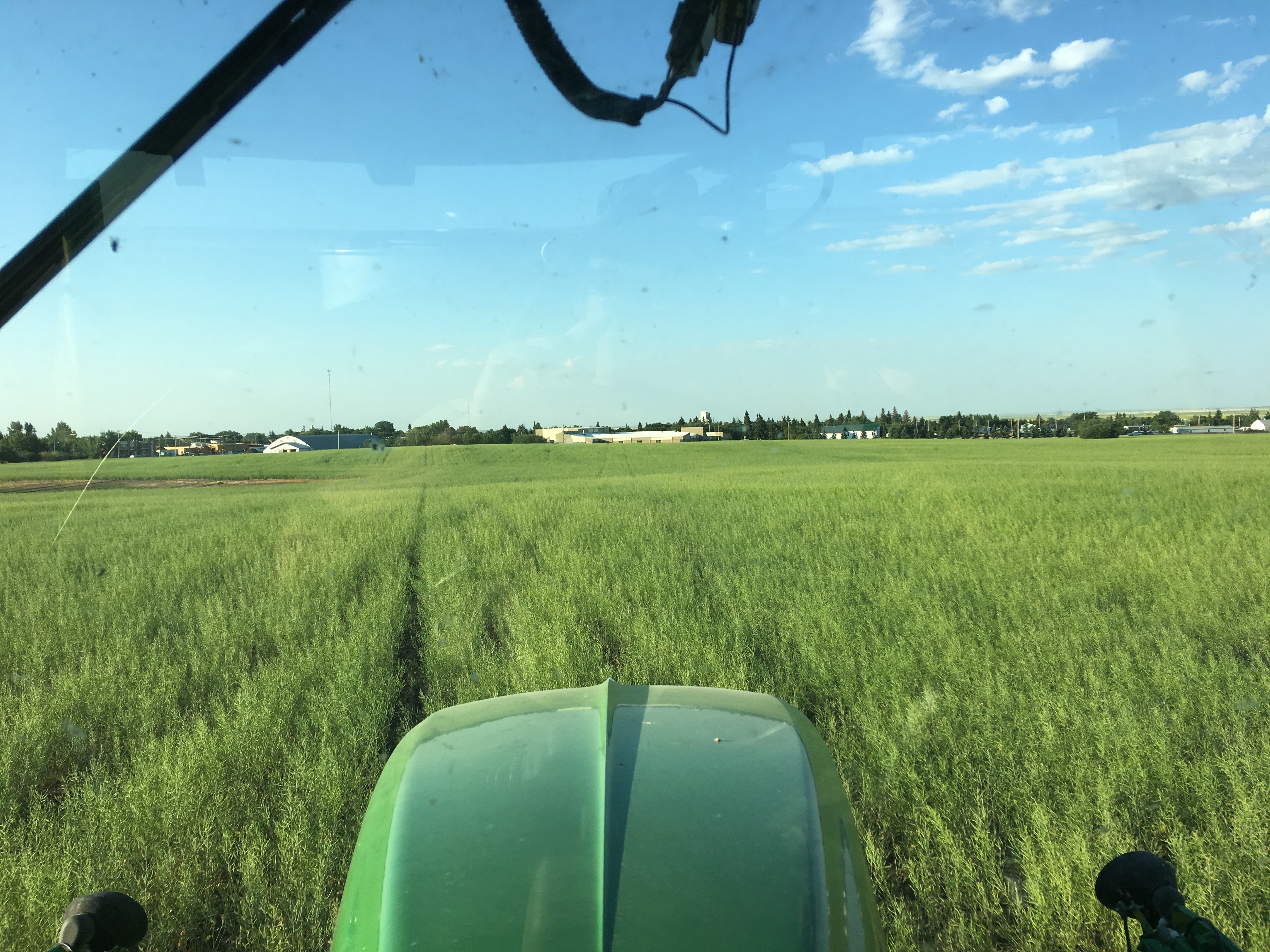

          what would you guys use as a trample %. 120 ft. booms , i was thinking about 1 1/2 %
          even if you said 40 bushell should equal . 6 bushell / acre x 10$ equals 6 $ acre
          does it sound about right. esp with no fungicide tracks to follow
            What size are your tires? The first number is the width of tread in millimetres.

                    You have 30.4" of straight line tire trample / 1440 inches of boom = .0211 loss. With headlands, turning and extra damage probably 2.5% crop loss is a good figure if your fields are relatively square and wide open. If your expecting a $500 an acre return your trample loss $12.50 an acre. I would call the plane!

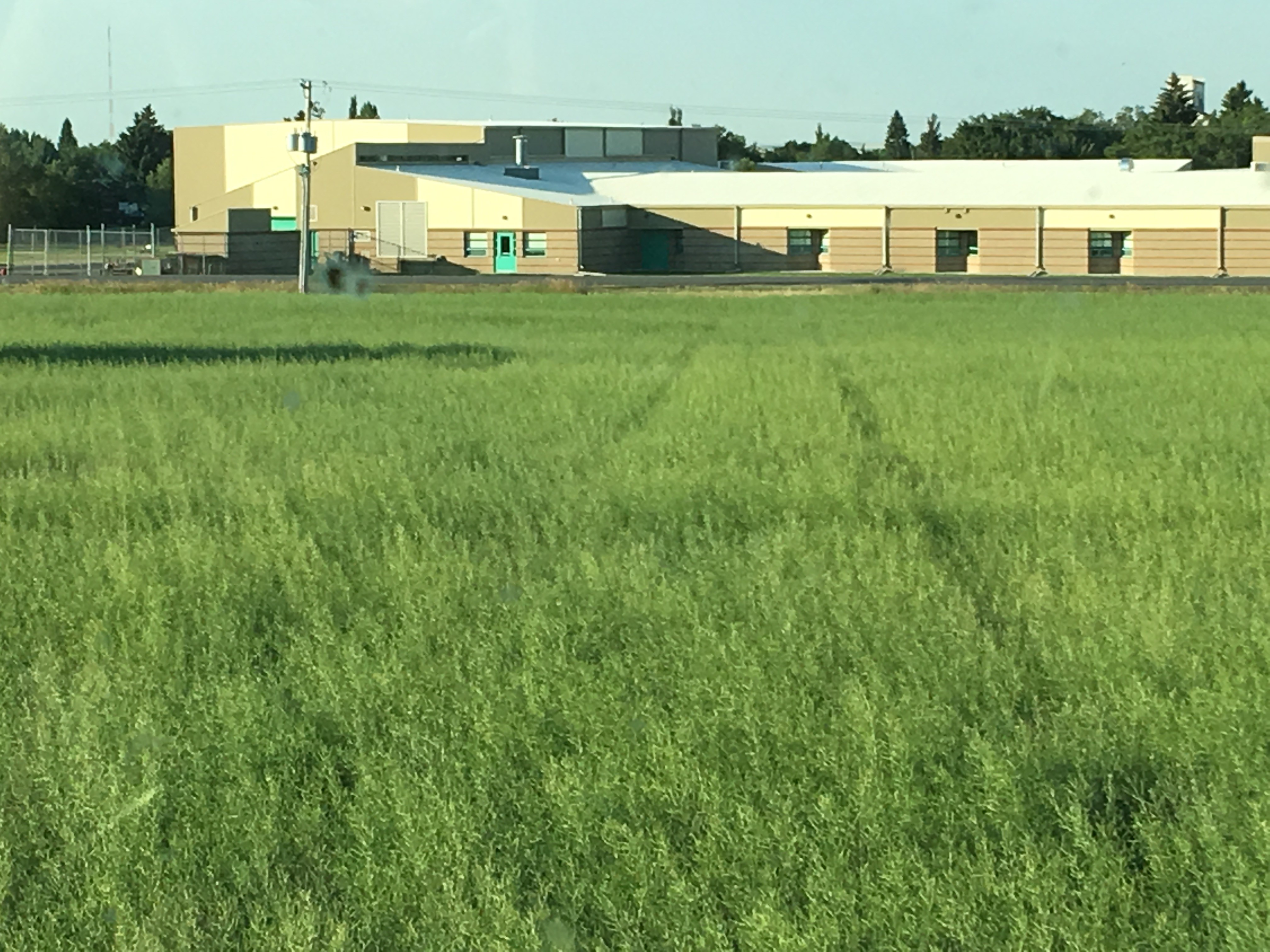

                    • Jagfarms
                      • Sep 2003
                      • 871
                      We used Coragen seemed to work good from what we can see applied some by ground and had some applied by air
                      Arial applicators would not have been to polular in Leader if they would have sprayed this field that we rent beside the Leader School
