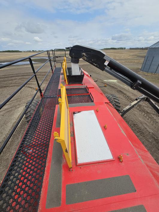

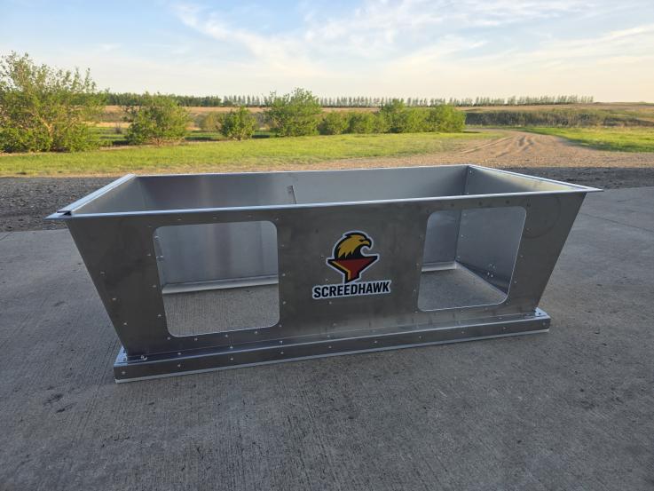

      80ft Vaderstaad Icon on 10", trash clearance can be an issue but being able to lift individual 10ft sections is nice, dump the odd lump and carry on. On sharp corners I pick up the inside 1st or 2nd gang to keep em from going backwards. Love this sliding funnel for filling by Screedhawk, can see when full from the ground, just fill to the top of the window then level off the excess with a push of the foot.

              Big lentil. I agree with and we do everything you do also. We will be buying the fill hopper. Looks handy

                We’re on our 5th year with our Vaderstad, running inline shanks with a paired row for cereals and a single point for canola. Takes about 90 minutes to change points with a few Milwaukee’s. We have one of them fill hoppers on order too, nice to see a picture of what it looks like. Wish we were done seeding but still need 4 more days and the fields just don’t want to dry up.
