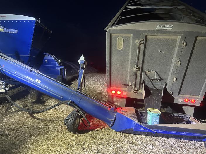

                  actually we bag everything in the field now to save time. Got a tri drive KW with 710 floaters on it and it’s my SP grain cart. Most of our fields are 10-20 miles away so it works good.
                  Used to do all our mechanic work in house but started sending some stuff out due to lack of time. Trying to update equipment to avoid downtime and stress as well. Had times when both machines were down at the same time for bizarre issues and that really sucked.
