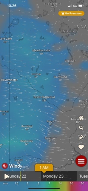

          Got going on canola yesterday started at 10.9 ended up at 10.1, light rain this morning no chance of going today. Hopefully tomorrow the sun comes out. Looks like a good chunk of Saskatchewan and Alberta received this rain.

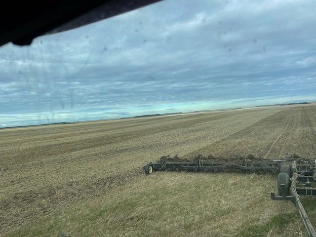

                Got the Gates coulter harrow going yesterday, straw still not dry but thought I would give it a go
                worked better than expected so did 500 ac . Even though we shaved the ground there are too many areas of logged stems that were flat to the ground .
                Can’t leave that for seeding outfits in spring , so chew er up now , not much snow catch anyway with the stubble that’s there

                  Furrow if I remember correctly you have a Seedmaster and a Bourgault on 12 inch spacing. Is the Seedmaster the reason for not leaving the stubble standing? Or the improved moisture conditions?
                    • 22602
                    Not this year , it’s just the best way to with lodges straw this fall
                    tge Only issue with the seed master comes from spray tracks or lodged straw
                    if it was nice even standing stubble , we would not touch it

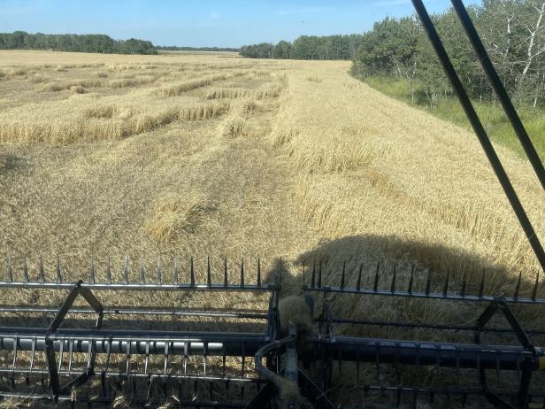

                      50% of the wheat was lodged flat , also random lodged areas in every field
                      headers worked awesome but depending on direction it was impossible to get 100 % of the lodged areas
