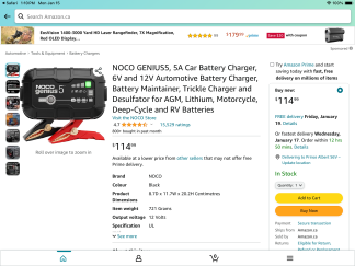

            We use one of these on all batteries , sometimes it takes two days sometimes 10 days to turn green , sure extends battery life . Batteries that come with new Toyotas ar NFG tho
              #96
              We use a two amp
                #97

                    That desulphator charger we have will bring it back to 100%
                      • 3371
                      For the cost of a $40 battery tender every single piece of equipment gets one left on all winter. Ive tried em all I still like the 750mah waterproof battery tender brand. Batteries sulphate when they get drawn down, freeze and there is a good chance they are shot, even if not froze everytime they are recharged a little lead is lost, eventually shorting internally. Then they are shot. Lead acid should never be discharged more than 50% even deep cycle. I rarely have battery problems, keep em charged. Also keep em clean and battery covers are your friend, dirty, wet and snow covered batteries will short slightly between the terminals. I don't care if its a 24k gold top optima if thats happening it will go dead quick.
