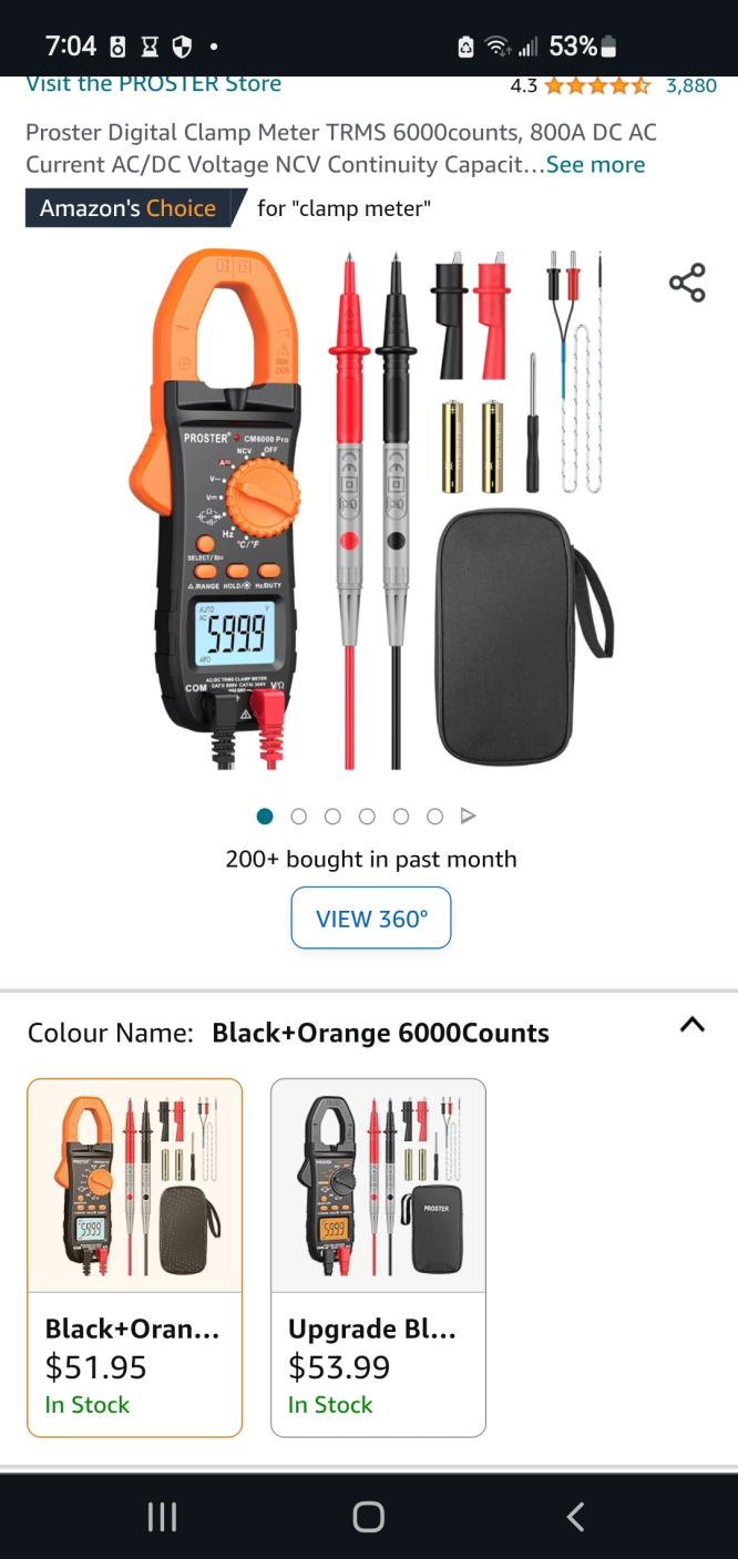

              Amp probe is a handy tool to confirm how much load you are drawing.
              Can also use it to check how big aof a draw you have on your panel when running multiple fans or moving grain with electric motors.
                [ATTACH]13387[/ATTACH]

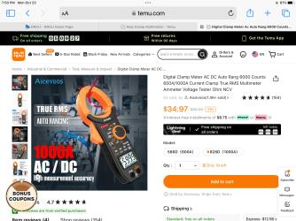

                Yea best thing ever , I have 2 of them , use them very often
                  Same one on Temu
                  Not sure how many use this website , usually at least half of Amazon, free shipping
