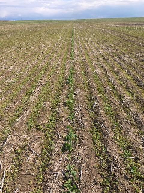

    Was seeding into a half of canola stubble this one time and was having constant plugged runs. Was too mucky, but I wanted to punch it in so I could change over to canola on lentil stubble. So I made the decision to split my seed rate between the fert shank and the seed shank on the hawk. I was a little concerned there might be some seed burn on the fert shank getting 130lbs of actual N in the liquid 28 streamed on it, but gave it a try. I could see no visible injury or reduced emergence in the fert shank row. That durum ended being the highest yielding durum ive ever grown, over 30000 bushels net off those 300 seedable acres. Would I try that with granular urea nope, i know better than that.

      I have also seen this with high rates of dry with a seed master
      The only canola not dead was the one strip from a plugged fert run on air drill
