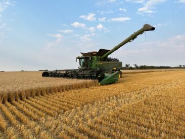

    We like our 45 ftsClick image for larger version

      Local guys have been buying 45’ and 50’ headers on case 9250 and used to run 40’. They found running side by side the 45’ ran same ground speed as 40’ and 50’ was only marginally slower than 45’.
      They have no idea why, but it seems the wider headers have capacity increases for case combines. These side by sides were in 100 bus barley, 70 bus wheat and 50 bus canola.
      Everyone has been pleasantly surprised and can not explain why
