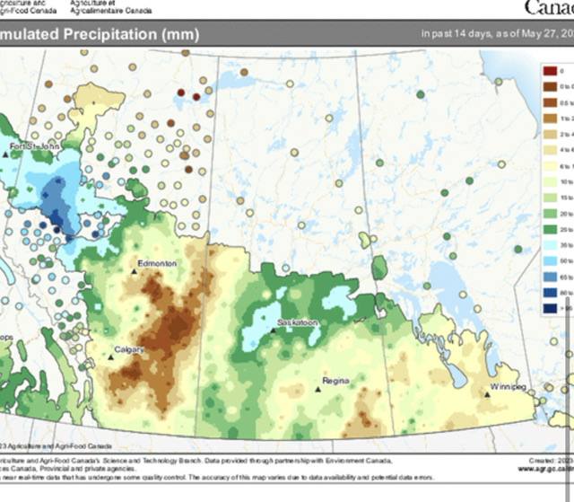

          • 22655
          #64
          Current 14 day maps definitely show how dry most of Alberta is

            #65
            Furrow. Looking more like the western half of Sask and eastern part of Alberta might get some moisture end of the week. Drew says less than forecasts suggest but still something. Hopefully it rings true and models are correct.
              #66
              Lot wetter in SE SK after the recent storms. Rep says only 25% seeded in some areas.

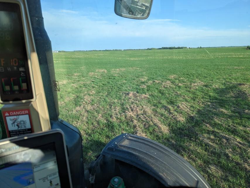

                  #68
                  We do have more straw and more furrow now than then. It's the furrowing that stops the tumble.
                  If we're back in that cycle, maybe the young bull will heed my warning about wanton rolling, or discing, or harrowing lol.
                  I've been working on my dad too, for years. Started telling him all that dust behind the machine is pay dirt blowing away in the wind. Seems to be coming around. Definitely a tradeoff though. Seeded wheat into oat stubble, and sprayed it last night. Some areas will be patchy with the straw piles that the drill left behind. Debating whether we should be looking into another drill to reduce our reliance on harrowing to make it work. currently running a flexicoil on 9" spacing. thinking about a pillar but worried about the maintenance. Seeing more seedhawks in the area, wonder if those would do a better job

                    • 9461
                    #69
                    And there's the problem. Drills need straw management. And we're asking it to break down faster, without tillage.
                    Seriously considering a 7 bar mid harrow here. Case combine the worst. Never ends.... Maybe an SR drill?..
