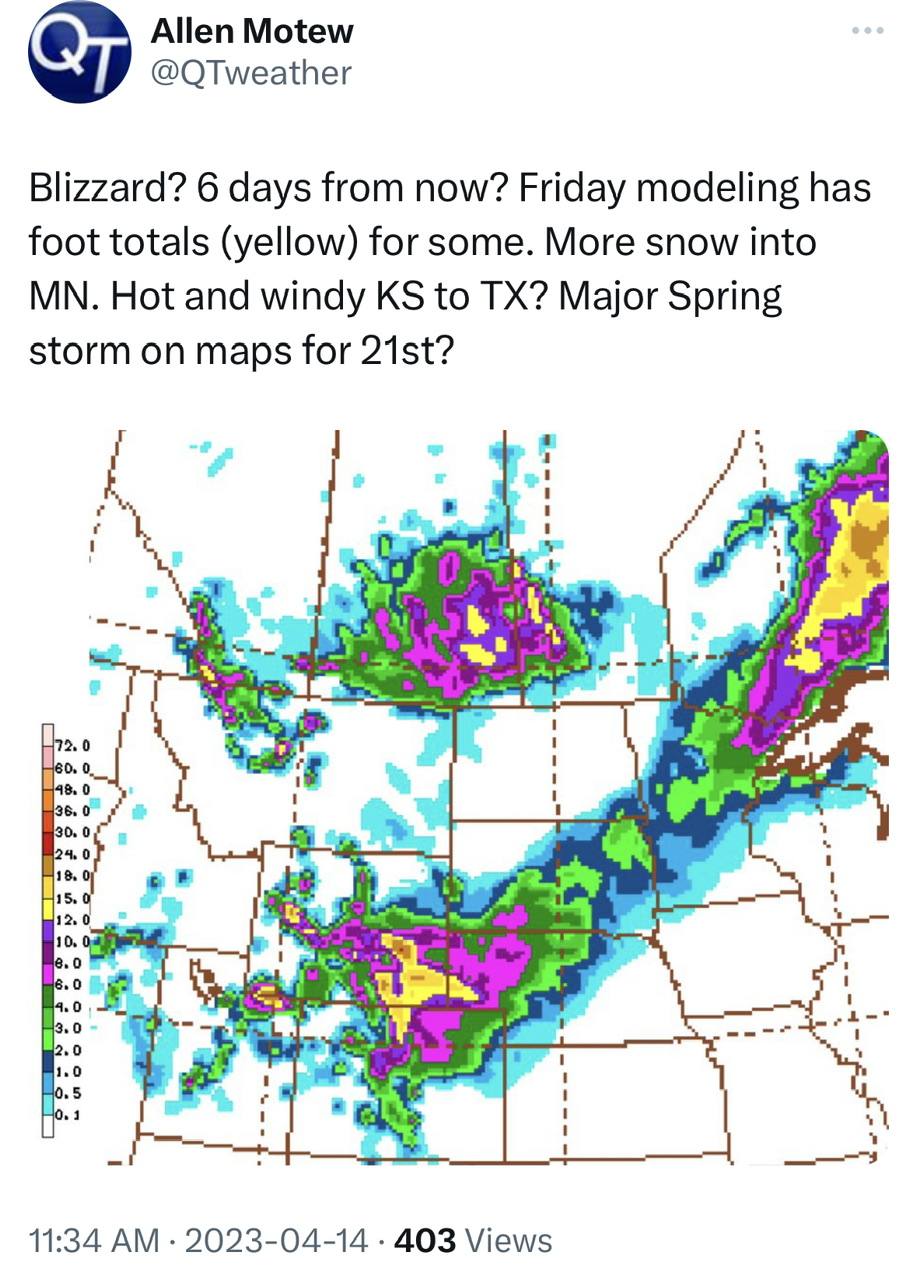

      Any one see this for next Friday.

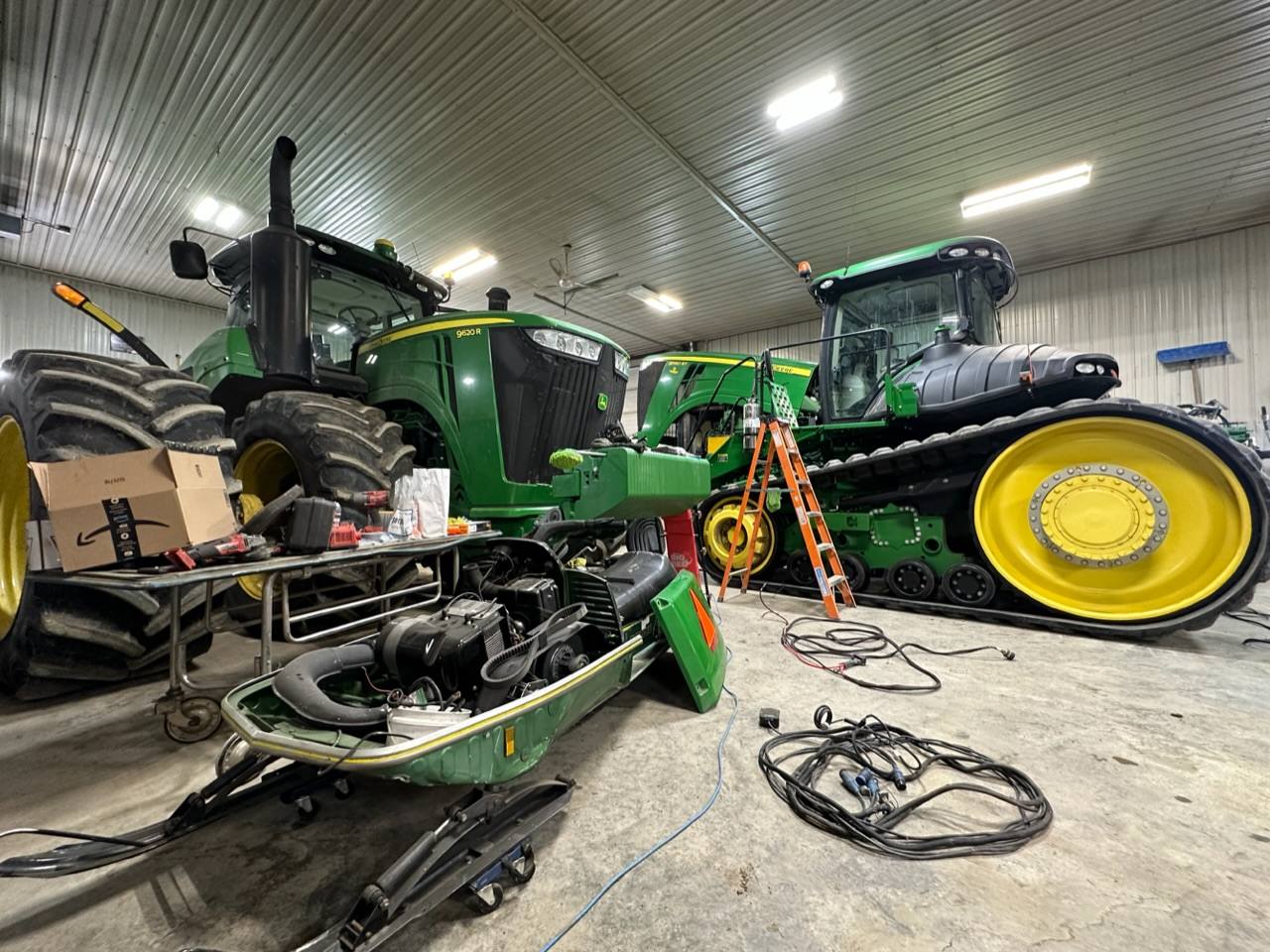

        Busy day changing out monitors new 9640 R tractor arrives monday

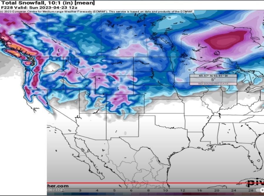

          yikes 8 inch of wet snow April 23rd. Hope they are wrong about this one.
              Bring it on. Heck I'll take 16 please ¯\_(ツ)_/¯

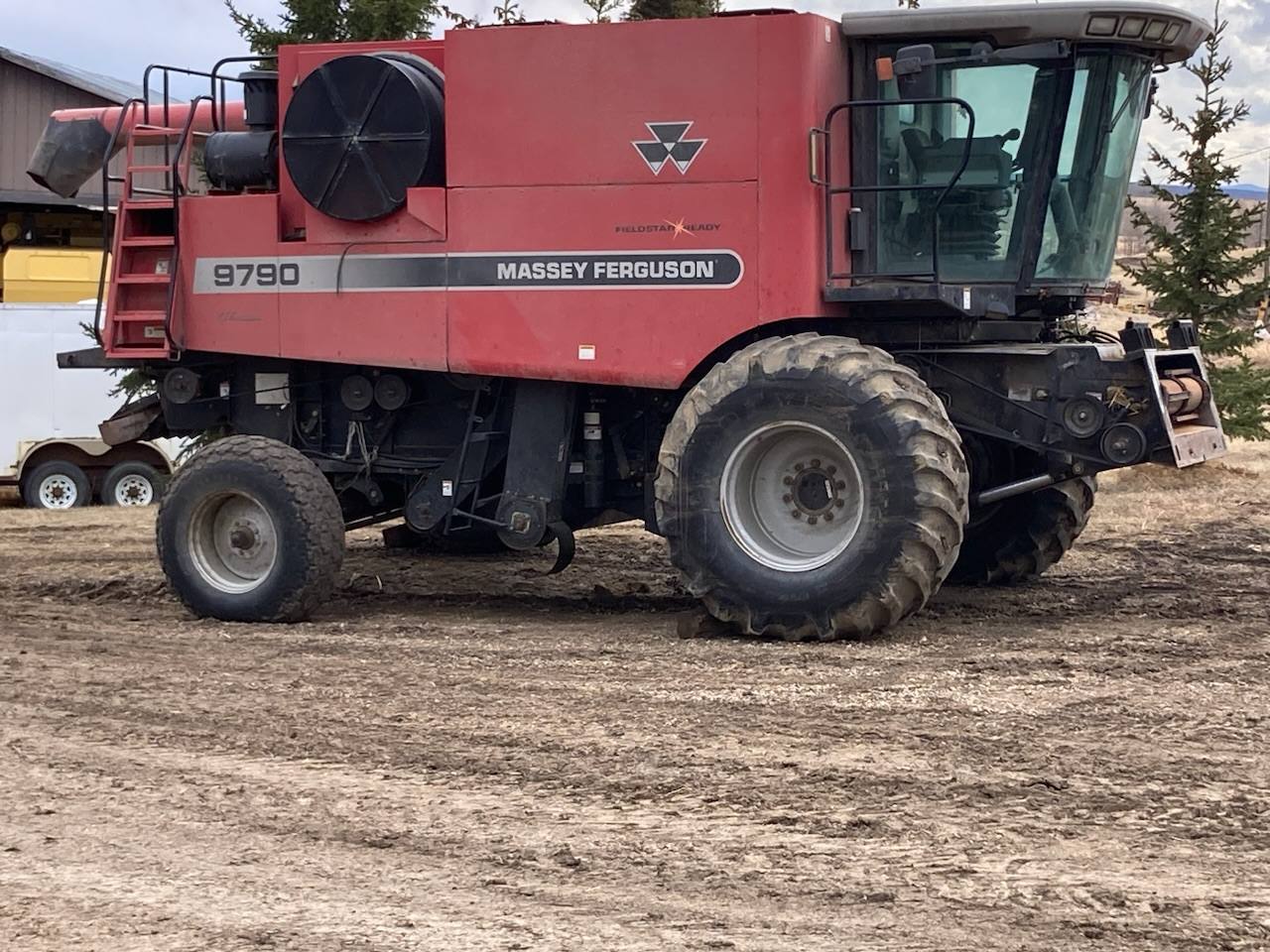

                The neighbours wanted to sell this unit last fall after harvest but it blew the injection pump half way through. They bought another machine to keep going and we bought it for parts for our Challenger since it’s pretty tired. My FIL’s nickname for this place is “Metalview Acres” since there’s a fair bit of retired iron around here.

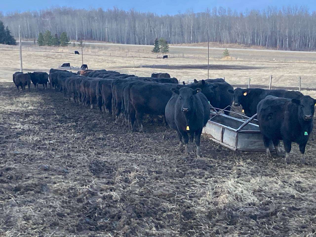

                Some cows enjoying lunch in the expectant mothers field.
                The best sight at midnight is a licked off calf that has sucked and is laying on the straw. Momma earned her kibble today. Got the first 10% on the ground and hopefully things keep going smoothly. One positive to how dry we are is that the cows almost have to go hunting for mud if they want to drop a calf in it. Definitely a bit concerning for the pasture but hey………… that’s next months problem. Why worry about it today😎

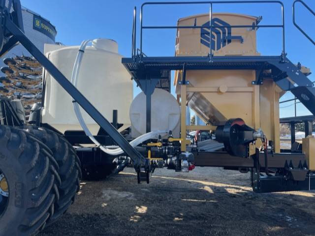

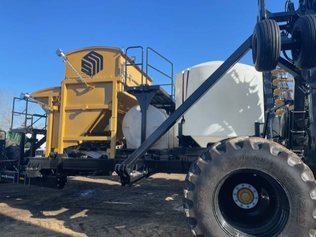

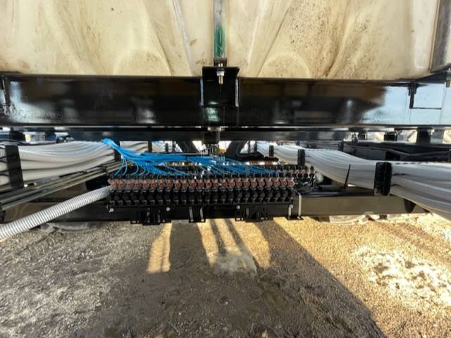

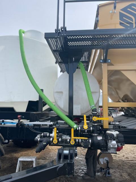

                  Yard dried up just enough this week to go over the liquid cart for the ole Bourgault and get the SM drill home Wednesday to finish our modifications on it .
                  Added an extra liquid tank on frame , changed out their factory fill plumbing to all straight 3 inch fill lines and added the Alpine kit .
                  Got a few more projects to do before it gets wet for a few days next week , will be welcome here .
                  Snow just about gone on the level , lots around yards , fence lines and bush where wind drifted it in . Not much water running , most spring potholes have water but are going down already with no ground frost .
                  Will be interesting where I ran the deep ripper in low lying clay areas last fall . Very little water pooled in those areas that always have water . Hopefully I did not create a mess with no bottom in those potholes . Time will tell.
                  Added the Alpine tank
                  And moved the catwalk supports
                    • 22655
                    Then redid the plumbing for filling
                    Added 3 inch fill lines
                    Then got Alpine kit on
                      • 22655
                      Once the supports were moved off the Center beam that gave us lots of room for the distribution manifolds to be installed under the tank out of the sun and still easily accessible.
                      Set up the way we envisioned now , hopefully works out . Will be used for all the canola , peas , soybeans, corn and the new small faba beans if we need to .
                      Will also do 60 ac of wheat again beside the ole bourgault now that this one is set up similar.
                      Last year was not a true test and machines were set up differently for fertility.
