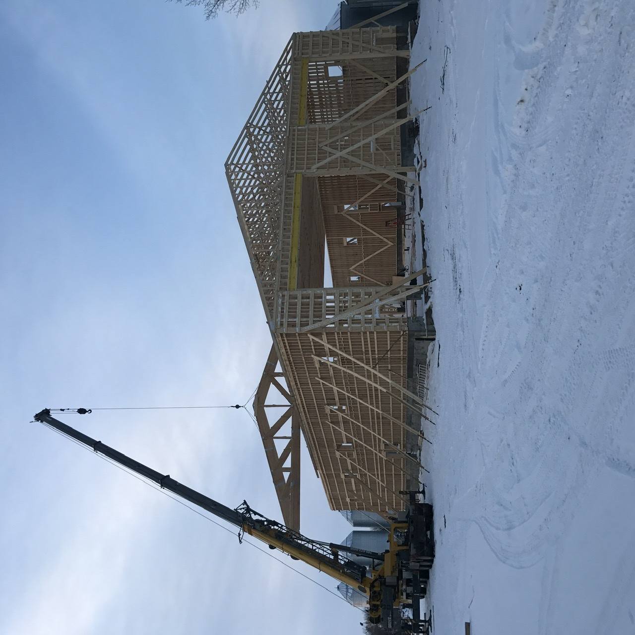

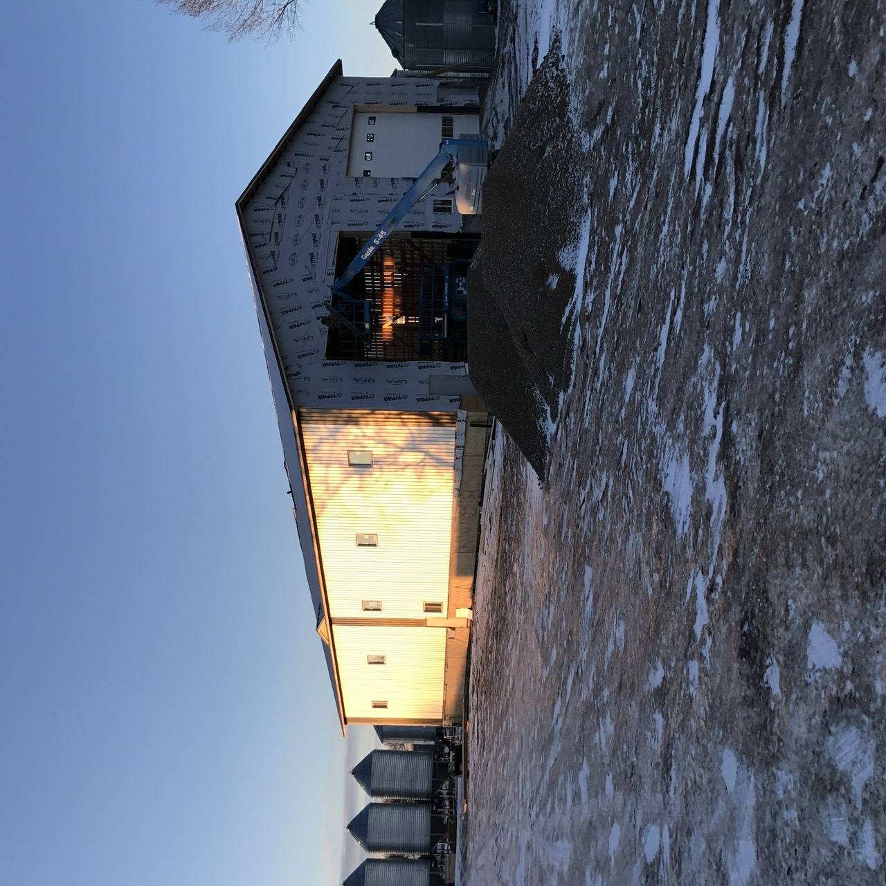

          Sorry about the orientation….70’x100’x20’
          The roof structure is of sufficient strength for solar panel installation.
          Building a lasting future is an interesting journey!
