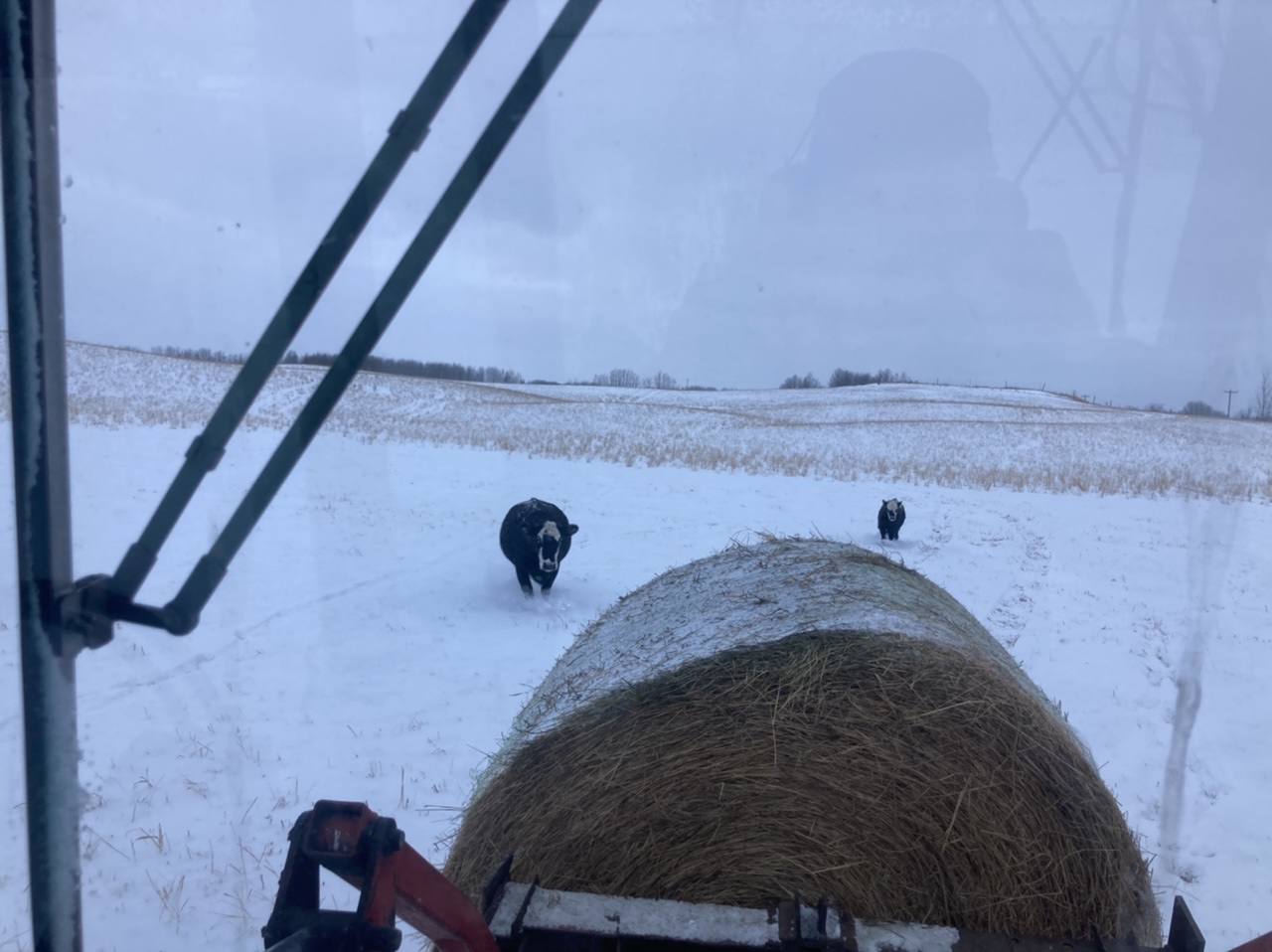

                      I despise winter…………….. actually it’s just the cold, snowy, windy, dark all the time part of it that I don’t like. Otherwise it’s great😎
                      The cows move much easier than in July with grass everywhere. Especially this pair that must’ve hid in the bush the other day when we moved the herd. They followed the bale wherever I went today😉
