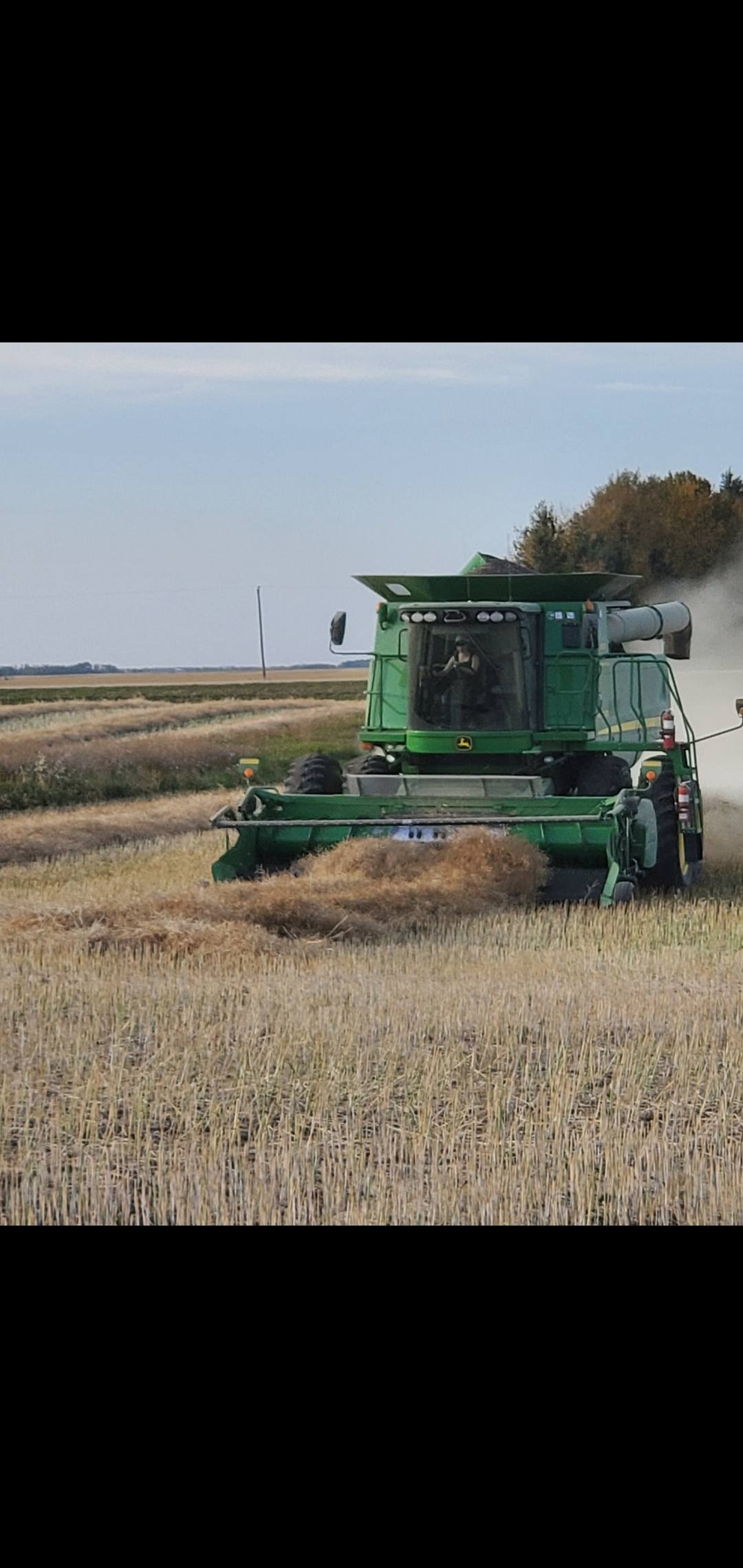

          Daughter picking up the last swaths of canola..
          We are done harvest 22.

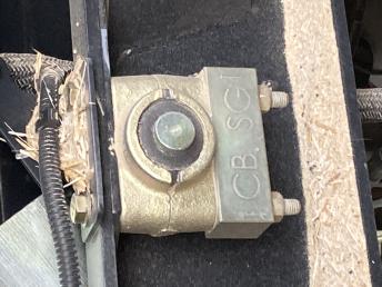

            That little block when below is in Corn and bean all Cases come from factory in the CB position, look at a NH it will be in SG. Just make sure the bolt location is moved on the top of that arm as well and turn shoe over by hand without a belt on to ensure no interference. Mine have been in SG for 3 years now.

            So ours is wrong BL ?

              [ATTACH]11075[/ATTACH]
              Yep block on the bottom is Corn and Bean like the little arrow shows, causes more of a kicking action to move heavy cobs out, in small grains its more of a back and forth seiving action. Here is the weird part, you wont find any info on it in the manual, and if you ask a case tech they will tell you that it will destroy your shoe if you change to SG. I guess it would if the bolt on the top of the hanger strap wasnt also moved to the proper location for sg. Then look at any New Holland all in SG position. My losses were cut in half in canola by moving it to sg and I think makes the combine feel smoother.
              You have to support the shoe with some wood blocks or rachet straps to make the change on both sides of the combine.
