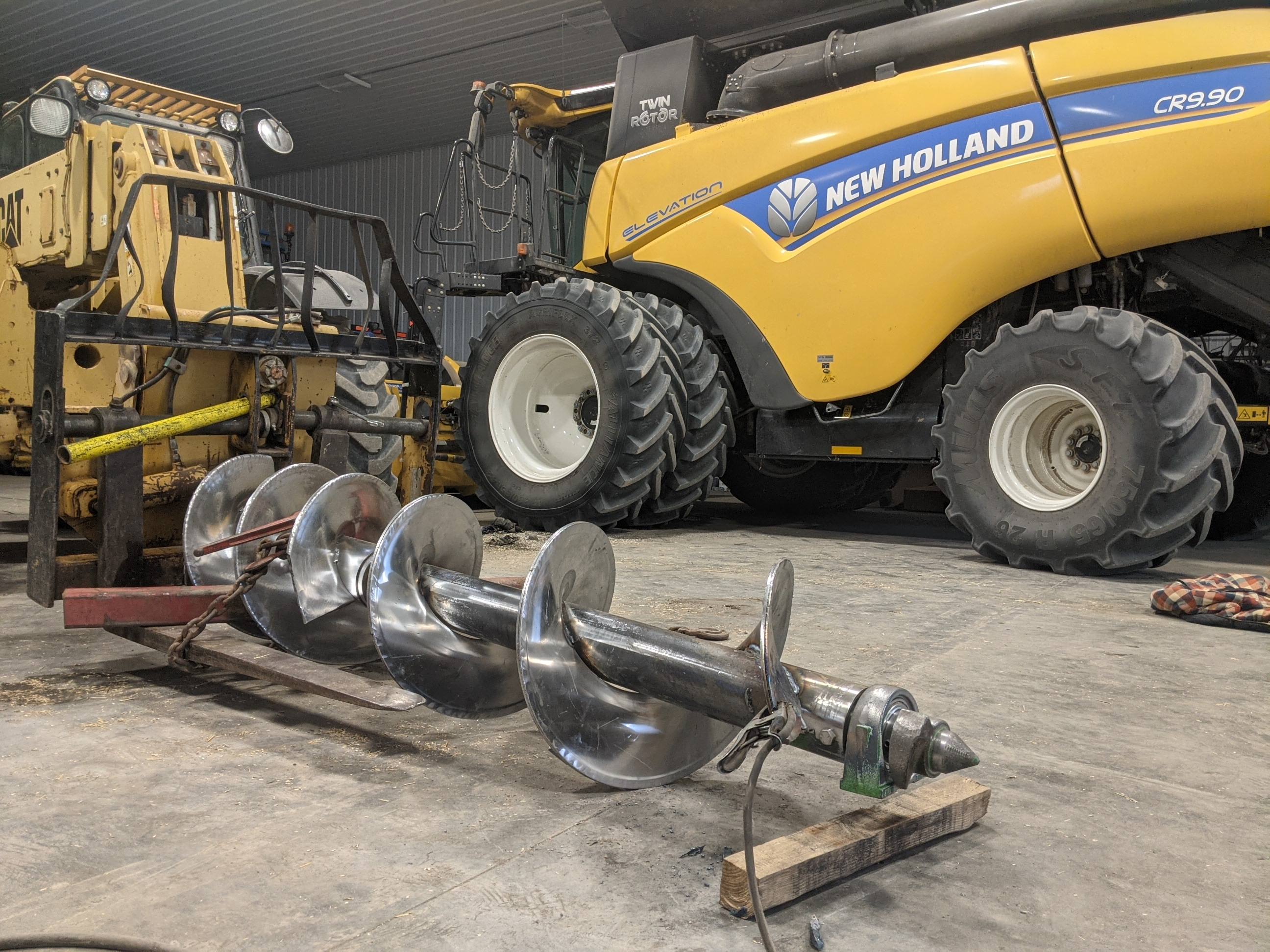

      We had a short day yesterday, only managed 200 acres and at 8pm we were crawling at 1mph with all combined grunting time to quit. Cart auger decided to screw up yesterday also, flighting welds let loose from shaft so spent last night heating, cutting, a lot of sledge hammering and welding, but ready to put back in this morning. Looking like a small day today with the fog heavy this morning.
      We had that also happen to our cart, the upper auger had a rubber torsion damper that stripped out and under heavy wheat it would slip and backlog the grain. Im not sure what kind of cart you have but ours was a 2012 brent.

        Our cart in a 1282 Brent, after getting it all,welded up again we spent hours trying to get the auger back into the tube. This auger has the 22” intake and then goes to 20”. we spent hours pounding with a sledgehammer to get it back down the tube. I was ready to throw in the towel but son in law finally got it pounded down after supper last night, so we’re back harvesting with a cart again. After not having a cart for 2 days you realize how productive it is.
        The 9.9 has good capacity, probably about 10% more than the red 9230 that I drive. We’ve had it for 3 years now and I still haven’t driven it in the field yet. Well another short day last night, by 7:00 we were chewing wheat at 2 mph and all 3 machines were grunting. Hopefully we can get out there by noon today.

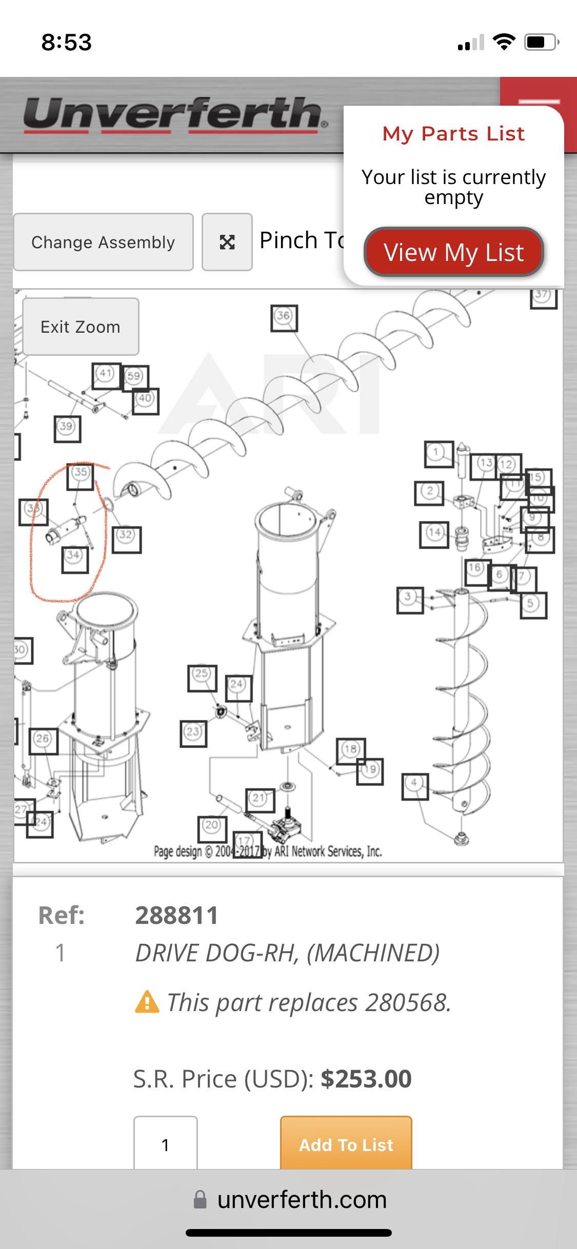

          Better check out this torsion, put one mark on the flighting and one on the coupler and use it a while and check to see if the marks are still lined up. If not the rubber is torn out in the coupler and it will put a ton of pressure on your lower flightings and gearbox.
