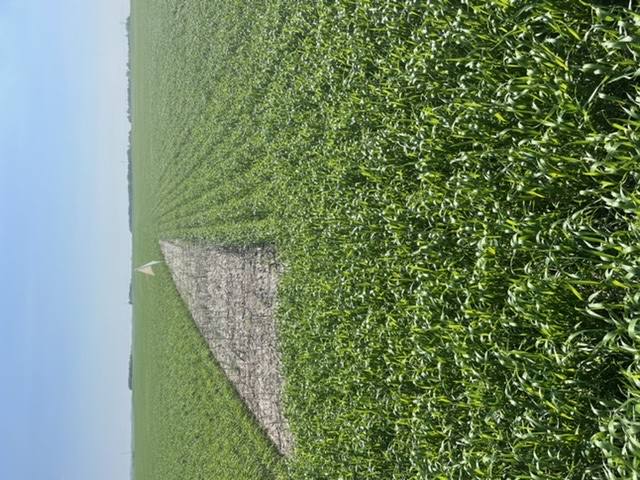

    Furrow do you think there will be a yield drag with 15 inch spacing on cereal crops? I do think the new seedmaster would be a fantastic canola drill but do you think there is an advantage over the traditional 12 inch seedmaster?
    Just following up with that thought…

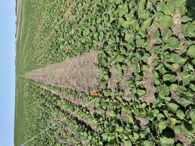

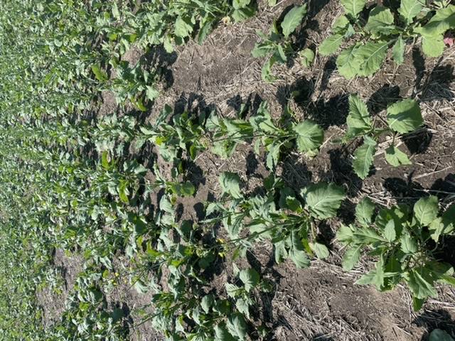

    Today
      • 22650
      12 in paired row
      15 in single row , same seed rate

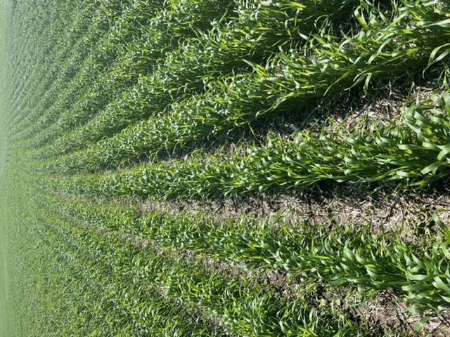

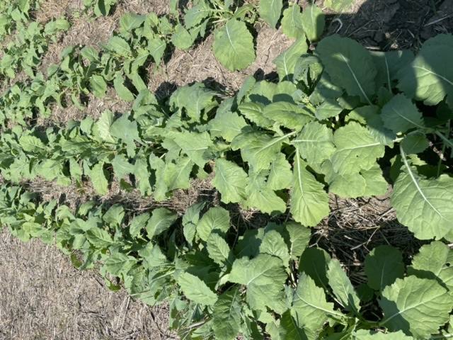

        • 22650
        12 in paired row
        15 single row
        Population very dense in that single row as expected

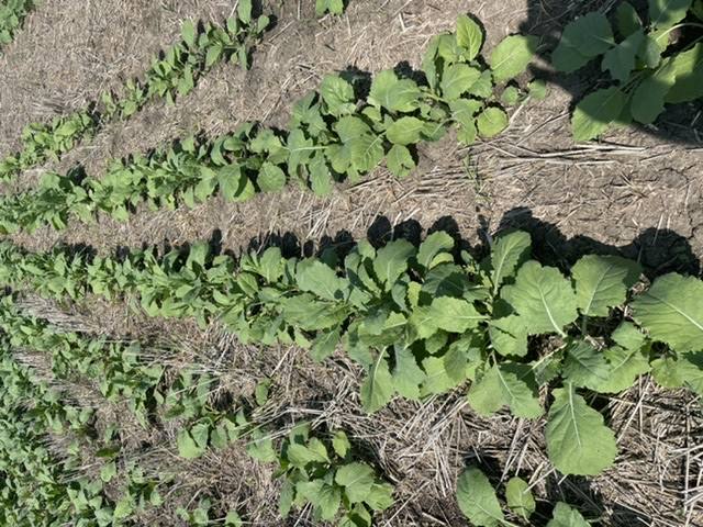

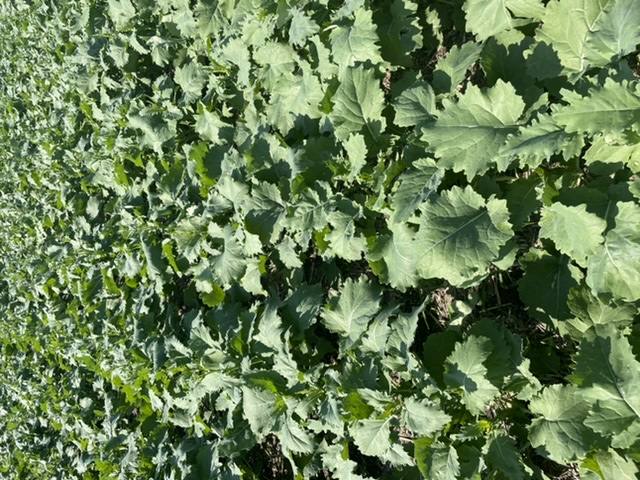

          • 22650
          The 15 in rows have nearly filled in now
          Will be interesting at heading

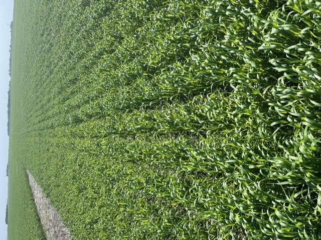

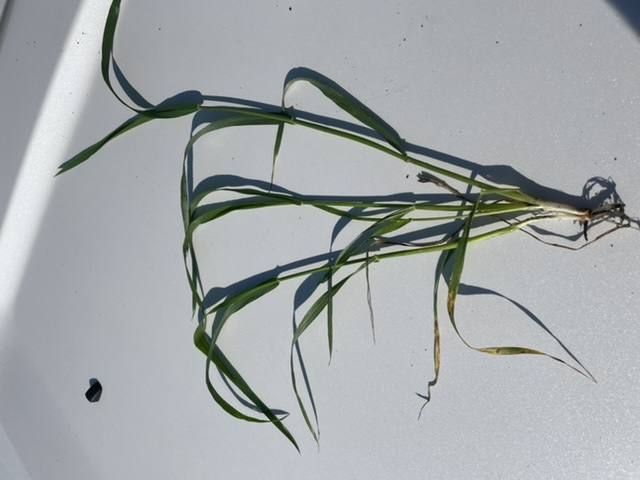

                • 22650
                Horsch right , SM left
                  • 22650
                  Horsch at 220,000 seeds / ac , 2.5 lbs/ac
                  Seed Master SR at 3.5blbs / ac
                  Both 45CS40 , same seed lot
                  Horsch has 4 gal / ac Alpine G22 in furrow
                  SM SR has dry phos in side band at 25 lbs / ac
